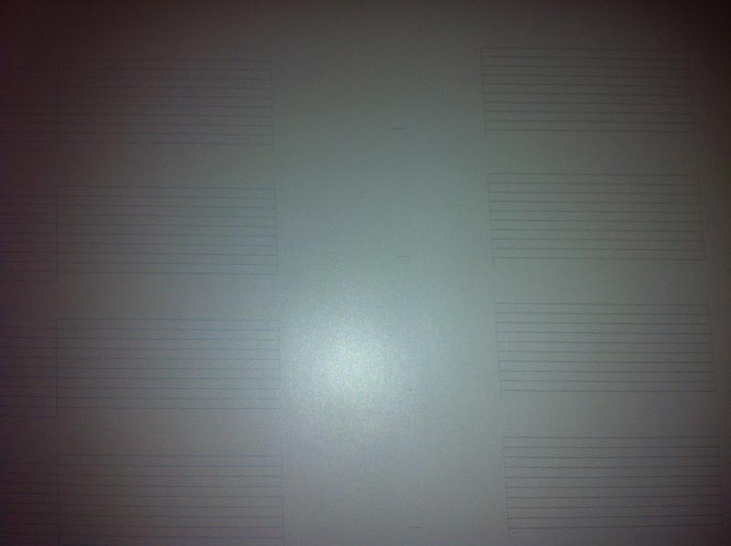

I noticed some banding in my blacks while printing yesterday and ran a nozzle check to find that 95% of the nozzles had dropped out of one of the black heads. I ran a cleaning to no avail. I have since gone though 2 head soaks and a magnitude of strong cleanings and cannot get them back, in fact not even seeing improvement. I did see nearly all of them print on one nozzle check immediately following the first soak but a second nozzle check had them all gone again.
This printer runs a lot so it has not set and has not had any head strikes recently.
I am at my wits end with this one, printer is 2.5 years old. Any suggestions are appreciated.
ndowd
I just completed a full head soak per the Mutoh article I found referenced on this site, soak for one hour re-wetting every 20 minutes. I am attaching a photo of my nozzle checks these are before and after the soak.

Possibility that your capping station is to blame. After a while they can stop sealing as well as before, or the drain lines can plug resulting in no vacuum on the head. Best bet would be to attach a syringe to one of the drain lines (cap off the other) and gently try to pull through the drain lines. Then switch lines and do it again. If you're pulling and pressure is building in the syringe then you have a block in the line(s). If you are easily pulling then I would put the head back on the capping station in the low position and gently pull to see if you're getting ink. (Reverse to the other line as before.) If you're pulling air then the seal on the capping station is to blame.
