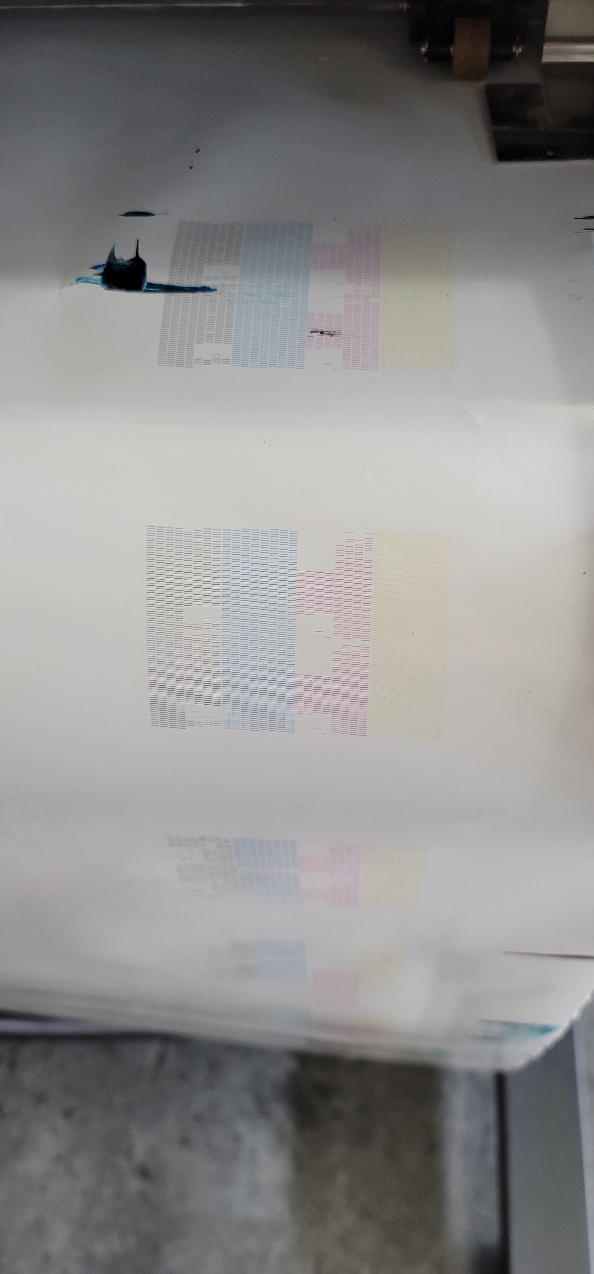

That was the problem. Just have to figure out the next problem. Why the colors are dropping. Yellow is perfect.
Before you make any more test prints, I'd be careful your media is flat to avoid any head strikes - in that photo it looks like they're a large ripple in the media, and the media clamp doesn't seem like it's holding it down. You really want to be feeding the media flat and smooth into the machine, and at a nice straight angle to avoid it buckling. That's not a solution to the drop out, but it will help avoid damaging your nice new heads
