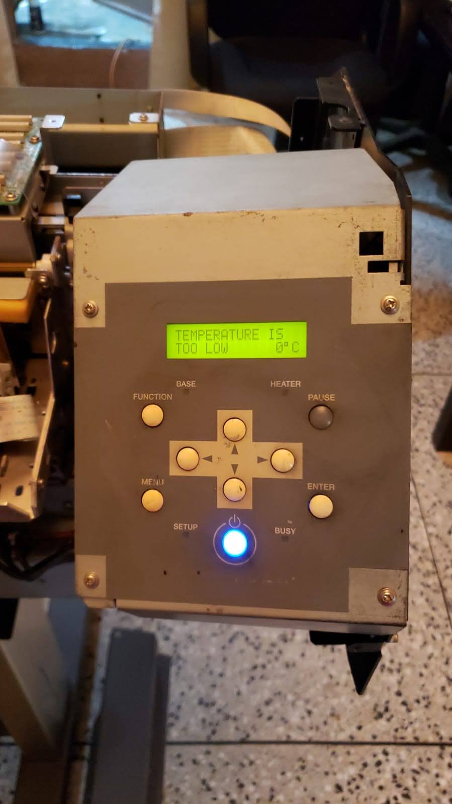

Keevan
The Vp has powered on! We changed the fuses and a couple transistors.
We have a new error. Temperature too low. is that because no heads are installed?

Vish B
Hi Keevan. I am having the same problem on my VP540. Which transistors did you replace
cornholio
You have to measure the base-emitter voltage of every driver transistor to find out the defective one/s.
If you don't know, what this means, ask someone to fix it for you.(otherwise you will kill the board beyond repair...)
