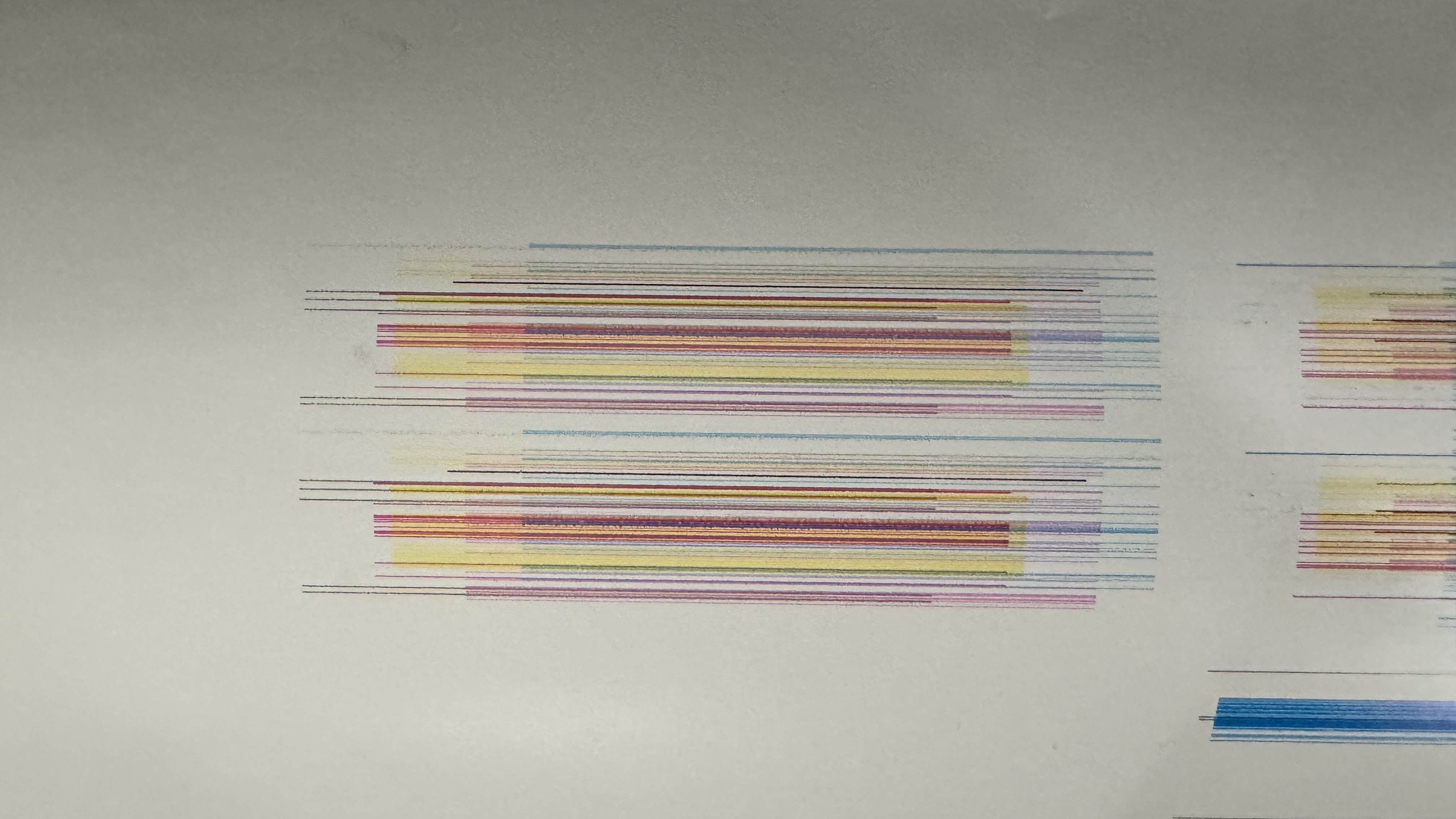

I have just completed a new printhead install in a VS-300i. I am getting a weird test print issue, see bellow image.
Can't seem to figure out what the issue is. Double checked cables, dampeners, correct orientation of printhead, headrank #. What causing this issue?

It looks like an electrical issue. I'd double check your cables again. Not just the head cables, but the cables from the carriage to the main board as well.

Ok, I put new cables in and this started. Double checked those then the old cables and it's still doing it. Was fine before i changed the head.

By double checking the cables, I mean to pull them out and inspect all of the contacts on both ends and replace them making sure that they're inserted fully, and straight. This would be difficult to do in the minute that passed between your post and my first post. If you mean you've done it before then triple check it. If you've done this, and they're ok, then you've got a problem with your print head or mainboard. My bet would be the print head, if the cables all check out.

Put the old head on and the test pattern looks like it should. Have verified it is the print head. Purchased from Digiprint supplies. Hopefully they accept a return or replacement.
