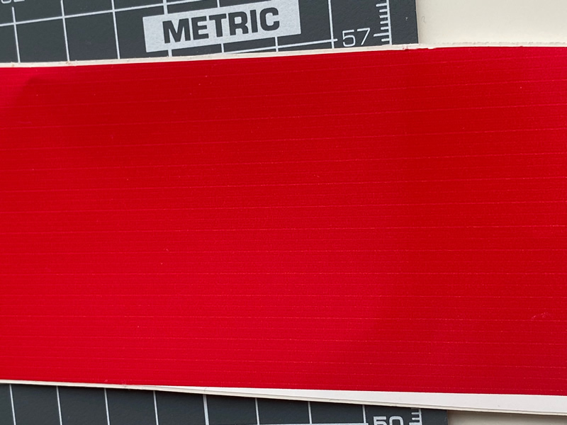

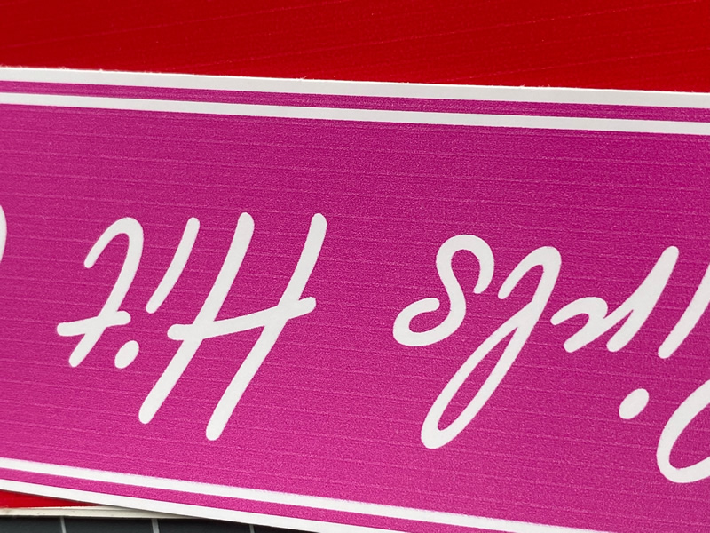

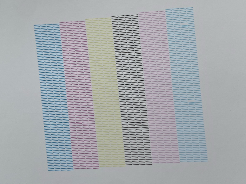

Hi, Im getting slight stipes through my VS especially on red tones. Is there something i can do to remedy this?
I have tried various cleans and the head looks ok but im no expert. Head is 18 months old and i clean it once a week.
Any advice welcome.
Thanks Steve

cornholio
Looks like you had a crash(deflected nozzles on magenta an black in the same area). If manual cleaning of the nozzle plate doesn't improve your nozzle print, you may need to replace the head.
Look at the service menu nozzle print, to see what the small dots look like.
