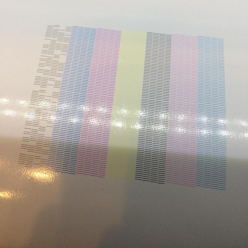

Hey Guys,
This is the only issue we've had in a year and a half on our VS540i, so I suppose you could say we're doing pretty good! :) The light grey channel appears to be dropping about 50% first thing every morning that we fire the machine up. Then if we run a medium clean, or two, it'll clear out and show 100% again for the rest of the day. The next morning we fire the machine up and light grey has dropped 50% again. This happens every morning it seems.
We have replaced the capping station last week and felt wiper and still having the same issue. The problem appears ONLY on light grey channel. The only other thing I can think of would be a damper?? Would that cause this?
EDIT: Also, today I did change out the light grey cartridge to see if it could possibly be the cartridge (hey, anything helps right?). I won't know if this works for a few days.
Any help appreciated :)

OEM or aftermarket cap assembly?
Air leak, fail to cap and seal the head, damper possible.
Was the Light Black Cartridge you pulled out empty or close to empty?

Still experiencing this issue. So far these have been done:
-I replaced cap station
-I have soaked head overnight in cleaning solution (poured into cap with printer off, then locked head back into position overnight)
-I have replaced felt strip
-Tech has come and replaced damper
-While tech was here, he sucked ink through cap station and there were no air bubbles
Somewhere it's losing suction overnight. Once I run a medium clean in the morning and get the grey cleared back up and 100% firing again, it runs all day and someimtes the next day (if I run the printer late). But if it's sits too long overnight, grey drops again until I run medium clean again.

zStill having this issue after adjusting "flush adjustment"

After three months, two tech visits, two phone calls to Roland (who simply told me to call my tech and use them as a last resort), replacing a couple hundred dollars in parts and having everyone tell me we have no solution......I called a NEW tech here in town who said he has seen this issue a couple of times already and was able to solve the issue in two minutes over the phone. It was 100% Roland's fault, and now we're stuck being out a couple hundred dollars when the newest firmware update fixed it. To backup my findings, there's another shop in Georgia who has the exact same printer, and exact same ink configuration and they fixed his by also changing firmware versions.
So in this case, how do we get our couple hundred dollars back for replacing perfectly good parts + tech labor, chasing a problem that Roland created with a firmware update? Only to fix it with a new firmware update three months later - telling me that CLEARLY someone at Roland knew it was an issue, regardless of how many times we called and they said no one has heard of this issue, just keep replacing parts. Roland has a way of never admitting fault - I've seen it over and over again on these forums....It really sucks.
