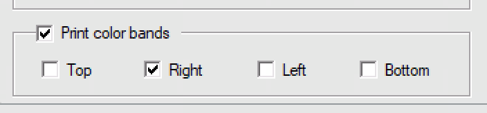

Did not say What Software. In Flexi select Print Color Bands. Not sure how VersaWorks does it.
