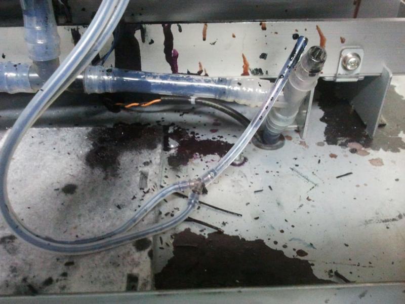

Hi All,
Mutoh VJ1604. There is a connector missing (please see attached pic). it is where the 2 small lines come out underneath the capping station and join in to the large line for the waste ink. Does anyone know what this is called and where I can get one?
Thanks in advance,
Brad.

The single pipe just drops down the big pipe and was originally just taped in position so it stayed in place.
As it is just the drain from the pump it is ok to just insert it as far as possible down the large tube.
SC
As stated. Drop it down the tube. That is how the old machines came. You can also wrap it up around the maint. station and plug it in the black holes where the wiper drains.
