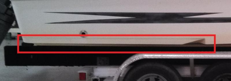

Waterline on this particular boat.
I would like install in suite with the rest of the boat, but I'm uncertain which here is the water line.
I of course will not install below the water line, Just curious as to which body line is the marker for the waterline in its self.
Thanks in advance.
Typestries
Be careful here. That Hydrasport sits really low in the water......see the large stain line? I have the same vessel, and can tell you they are deceiving. I'd set it well above the thru hull deck drain. Might be worth floating the boat on a calm morning and marking it out with a grease pencil.
