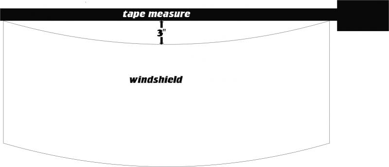

Myself I just run my tape measure across the top of windshield from left to right, then measure the distance from your tape to the the windshield in the middle. Use the rear view mirror to judge the middle easily. This distance is the amount of horizontal bow you wnat to apply in your software to your design.
:thumb: That's what I do.

Thanks all, great idea, makes sense, my only question is in regards to the mirror, you said use it as the "center" by that do you mean the mount of the mirror would be in the center of the decal up and down, or do you mean use it at the center of the top of decal?
