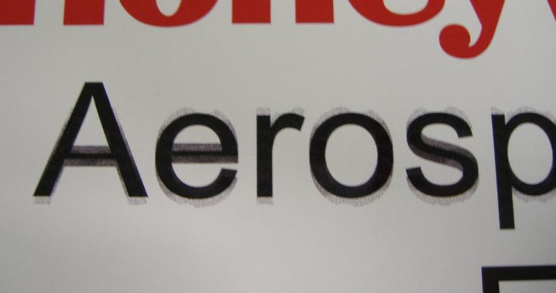

Anyone ever had their 1604/1204 do something like this?
the file is fine.. looks like it went schizo on me for a couple passes. ?
Aklaim
Try re-ripping the file. Ive had my 1614 do weird things, not quite like that, but print errors nonetheless, and re ripping has always fixed the problem.
jc1cell
Seems like it's a rip issue since the other black copy doesn't have it and neither does the red above.
jc
Dave L.
Re-Rip, If it's still no good, Try another file with similar characteristics. If that looks fine, you may need to rework the root file. If not, i would say static or your linear encoder needs a swipe or two.
