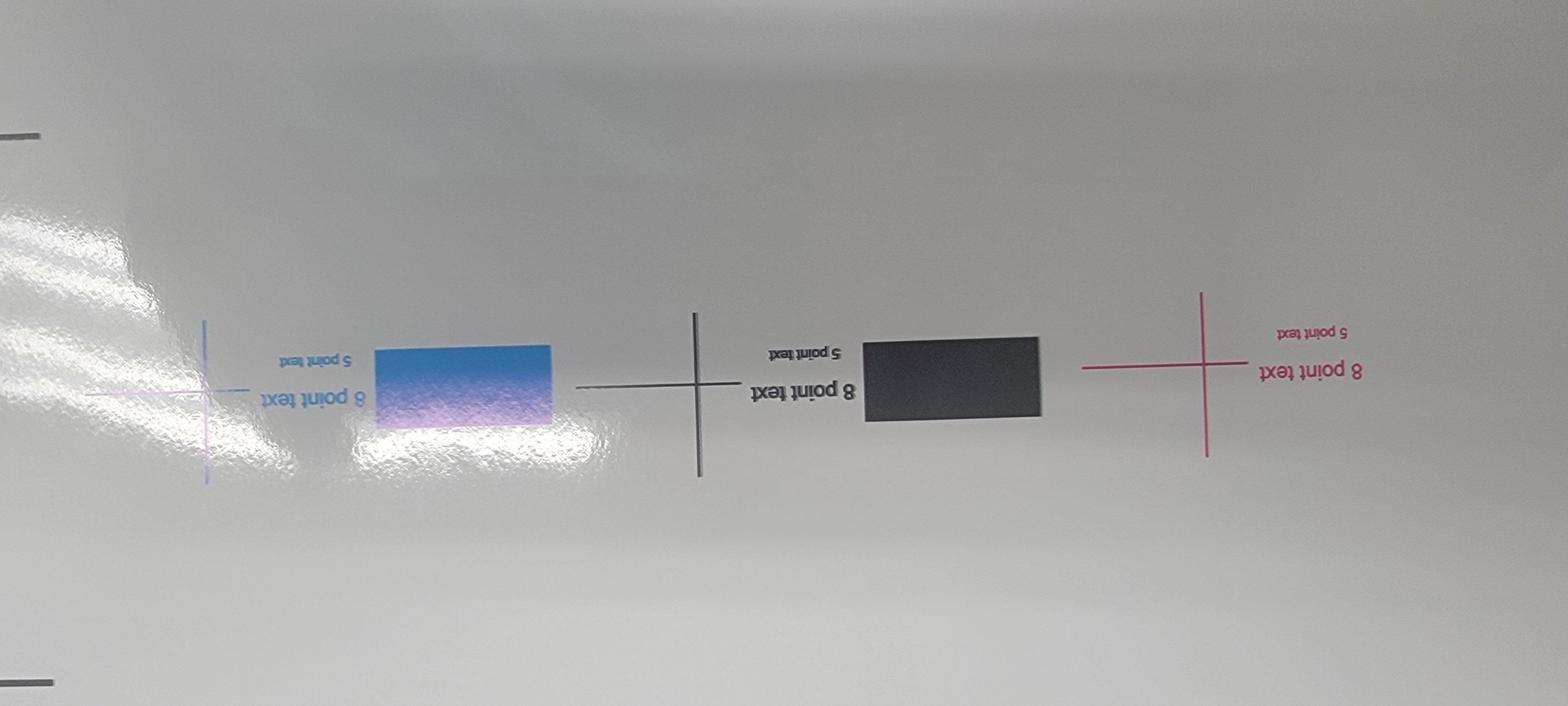

My five year old Mutoh 1624 is slighly smearing/overspraying black and cyan inks, but only from left to right (as the print head moves from left to right). In the last six weeks I have replace the print head, the dampeners, the encoder strip, the encoder sensor, and the maintenance station.
I didnt replace the encoder wheel or sensor that is on the side of the machine because I assume that only controls the feed and not the side to side motion of the head.
When the machine is in the normal bi-directional mode, the smearing is on both sides, when I change it to print in uni-direction mode the smear is only on the left side.
You can see in the photo below that the black and blue are fuzzy but the magent
a is near perfect, even with 5 pt type.
Any suggestions on how to correct this or what is causing it?
a is near perfect, even with 5 pt type.Any suggestions on how to correct this or what is causing it?
