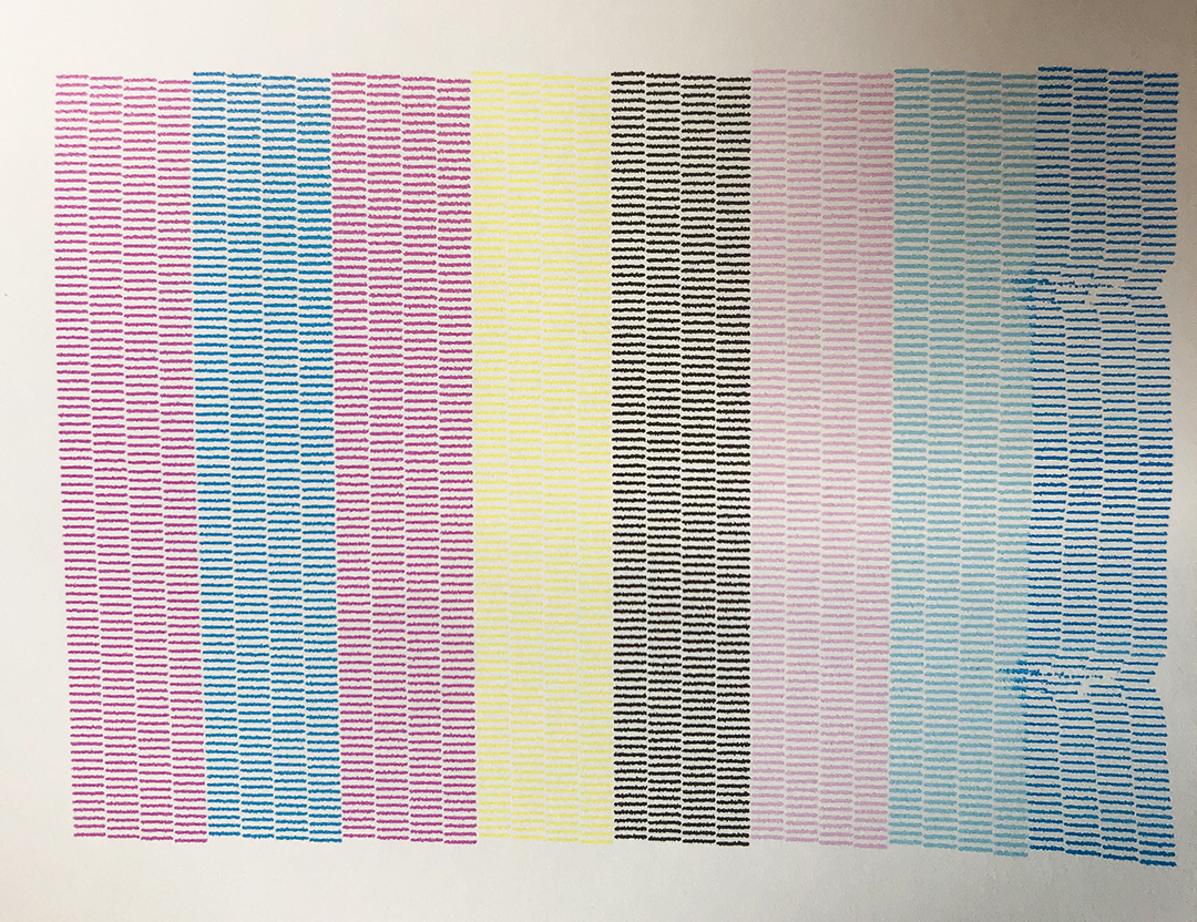

Anyone have an idea of what's causing this weird distortion on my test prints?
I have gone through a few cleanings and 1 powerful clean and have also cleaned the encoder strip.
I started noticing my prints were getting a slight fuzzy and ghosting on some of the edges of graphics when I printed something.

It looks like you have had a head strike that has distorted the head, either that or it is delaminating.
Try doing a good manual clean and inspection as well in case there is something stuck to the face of the head. It is also worth replacing the encoder strip and sensor as they don't cost a lot. If none of those improve it it is new head time
