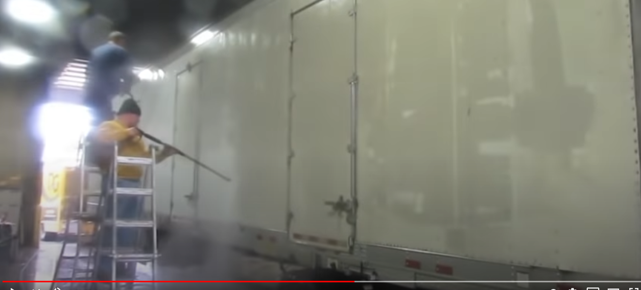

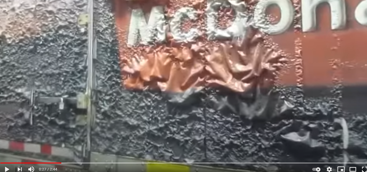

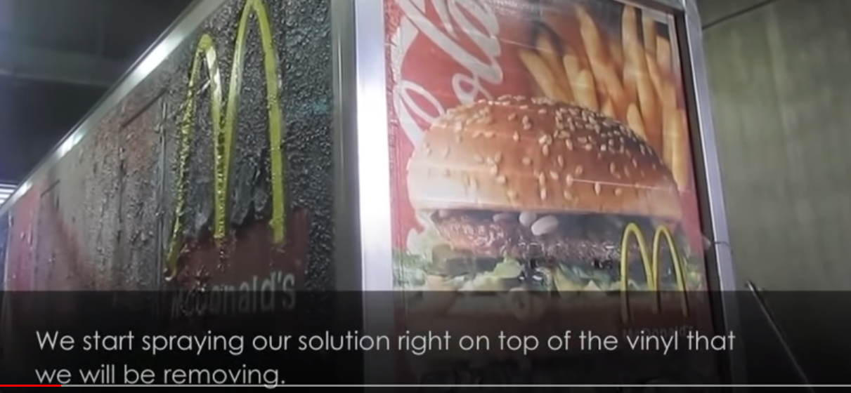

What did these guys use to remove this trailer wrap???
I found this video on youtube:
The guys first spray on what they call a safe bio-degradable solution and the vinyl appears to just bubble up and slough off...
They then come back and pressure wash the glue off.
What do you think that solution is?
View attachment 154014 View attachment 154015 View attachment 154016
This has to be SS1 decal remover from New Image Technologies. These guys in Illinois developed this formula many years ago and it works exactly like this. We used it on a fleet of trailers before and purchased 55 gallon barrels of it in the early 2000s. Definitely pretty toxic stuff, we used it on trailers that had 20+ year old vinyl on them and it was absolutely the only thing that would work to remove the vinyl. https://ss1adhesiveremover.com/ product info and the actual company website. They are legit and you'll see similar pics on their website of removals like this. http://www.newimagetech.net/
