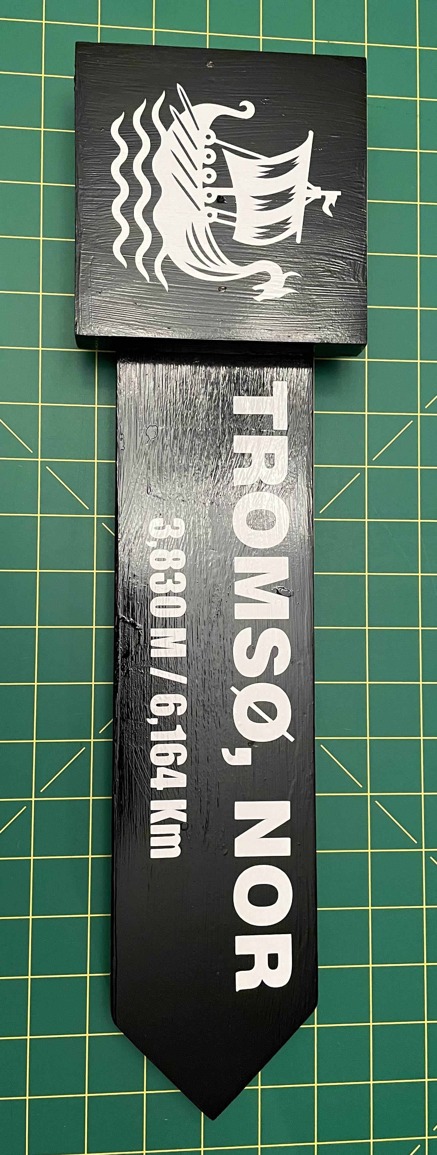

Airbss9
I use One Shot enamel paint and Orcal 651 vinyl. If I really want it to last in the elements, I coat the completed sign with Minwax waterbased Spar Varnish. I have had great success with this combination. If you use the Spar varnish -thin coats.
