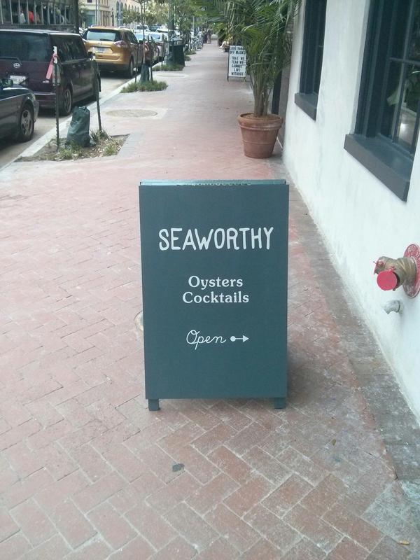

I built a sidewalk sign a few months ago and I used benjamin moore paint because the client provided the color codes.
I painted it with a stencil. It came out alright. I had an issue that the paint peeled of the primer once but i fixed that.

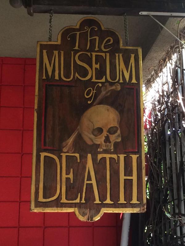

My current job is to build a sidewalk sign and a hanging sign. The client provided the image:
I am going to paint it with a stencil. I have some red and black One Shot. I need brown, light brown and yellow paint.
The question is: can I use a paint by benjamin moore or sherwinn williams to paint the signs?
They can mix any color you want and that is convenient.

When I used to make hand painted signs I used Kilz primer, Pittsburgh for the background color and 1 shot for the lettering. This was before 1 shot changed formulas. Pittsburgh is a quality product for background colors. I still have some signs from over 20 years ago holding up using these paints.
Today, most paints aren't all that good for outdoor durability. Prepping is your only hope regardless of what paint you use. If your other sign peeled, that's generally an indication you didn't prep correctly, whether you had too much dust still on it, didn't tack properly or simply rushed the coats of paint. There are a lotta ways for paint to peel..... even incompatibility.
As for rest, how do you intend to do the skull with all the fades and gradients ?? Do you have an airbrush or are you gonna just dry brush those effects in ?? Also, when working with those light colors on a dark background, your paint buildup could get a little outta hand, due to the opacity [or lack thereof] of oil or water based paints these days. Without lead in the paint, you're gonna be lucky to get 5 years.
