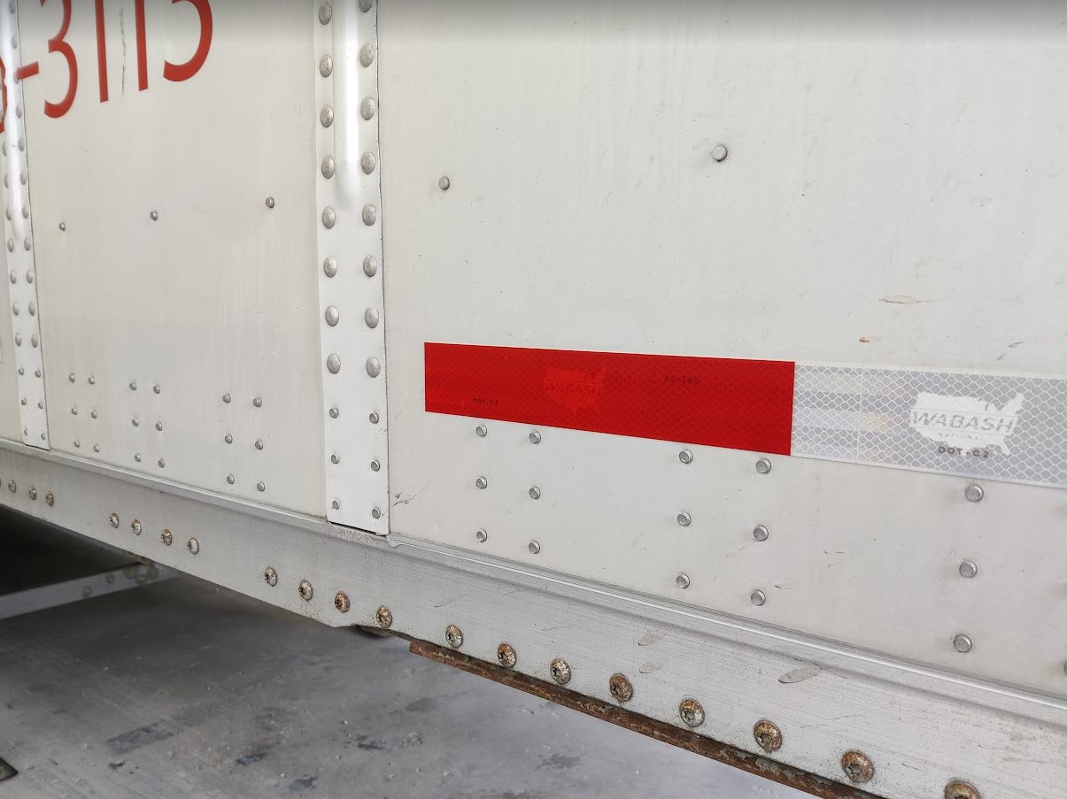

I have a new customer who showed me a trailer that was wrapped about 4 years ago using all 3M cast. That particular trailer had these small rivets with flat tops and sharp edges and the wrap had failed horribly.
Everywhere there was a rivet the vinyl had cracked and separated with the little rivet poking thru like the ALIEN coming out of the guys chest!
Luckily the guy doesn't want me to re-wrap that trailer, but the trailer he wants me to wrap has those same rivets along the bottom of the new trailer:
I'm thinking of telling the guy that we need to start the wrap above the three rows of bottom rivets where the reflective tape starts which I think he will go for considering what happened to the old trailer.
The problem is there is another row of those same rivets about a foot up and another row about half way up the trailer, luckily spaced further apart.
I need to prep those rivets in such a way to prevent what happened to the old trailer.
I have thought of 3D Printing a cap to slide over those rivets that would make them look more like a regular rivet or adding an extra disk of laminate on top of the rivet or wrap to give it more strength and hopefully keep it from failing too soon.
I'm kind of grasping for straws here, I need to come up with a plan soon... anyone ever run into these rivets before?

Yeah keep the wrap between the rivets at the top and bottom, and for the other ones, you will have to cut around them when you're done. Tell the guy wraps don't last forever.
So you think cutting those rivets out is best? It makes sense, they will fail anyway, I guess it's best to remove it to begin with...
weyandsign
After the vinyl is over the rivet, heat it with a hair dryer and push down around it with a squeegee. Then cut around it with xacto knife.
Stacey K
I like making signs
It's one thing to cut around a few rivets but if you have to cut around 10's of them...that's going to take forever and suck.
Would it make more sense to install an aluminum panel over the top and letter that instead? Or just avoid the rivets as much as you can.

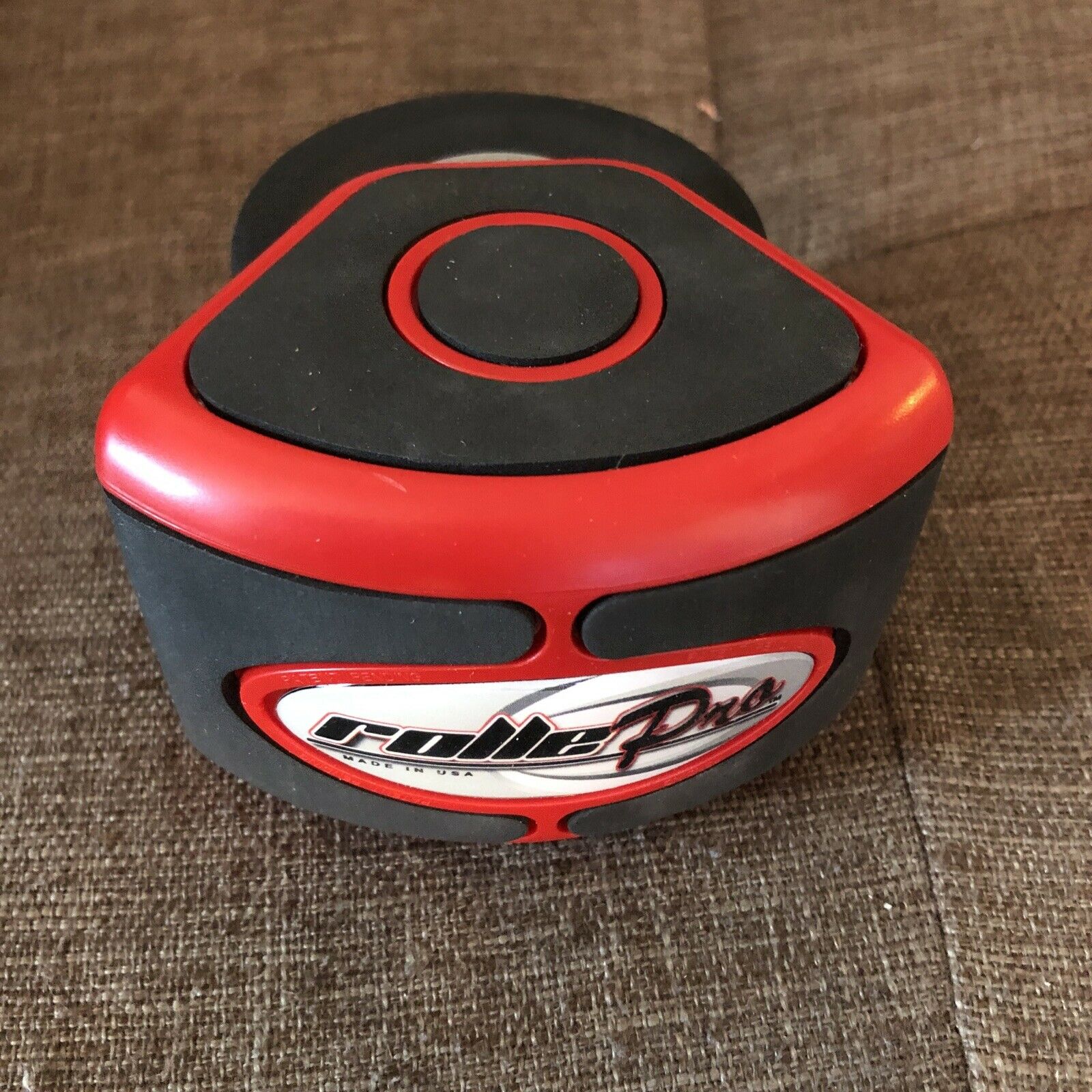

eBay enter this in the search, rollepro vinyl application roller
Buy Two or 3, these things are worth tripple their weight in Gold.. These are seriously that good.
