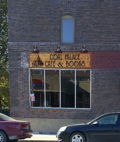

We are bidding on a project for a historic building and the client would like to have a wood background like the attached mockup. I was thinking something 2" thick or less and I found a product by Wensco called "AllWood" sign blanks. Just for the material alone, at my wholesale cost they want almost $1k. Seems way too high for a piece of wood. Also was looking into sandblasted HDU but not sure how "real" that's going to look. What would be a good material for this? I will likely hand-paint the sign onto the substrate to go with the vintage style.
Thanks

I did the mockup for the client and I just used a stock background photo I had for the wood. So yes, they want to see the wood grain, but no it does not necessarily need to be real wood. They want the look and thickness. I will google Chemetal and check them out. Do you have a direct link to their products?
