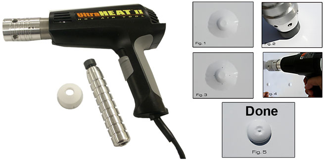

Always though someone should invent a tube like device that you could apply over the rivet and it would apply pressurized heated air to compress down onto the area whereby forcing the wrap material to conform to the rivet.
don't go stealing my invention :rock-n-roll:
ChicagoGraphics
Your to late, there's something called the Torpedo it's been out sometime, without the heat though.

sorry too late - somebody did this as an attachment to heat gun.. its patented. it didnt work well.. i had one. still have it in my kit. rollepro is what i use.
