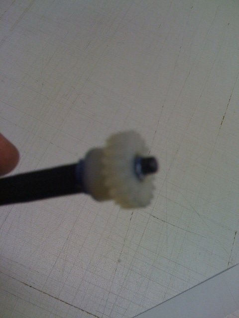

I've had this happen twice, and am now out of spare parts to fix it. I have had a line get caught in the gears of the ink pump, and it releases ink all over the maintenance station. Most parts are fine, I can clean them and they work, but there is a plastic gear that drives the ink pump that is softened by the ink and the teeth go to mush......
Anyone know where to buy just this gear. It is black, longer, and has a small gear on one end and the larger gear on the other (I'll post a pic here tomorrow..) I've called solventinkjet.com but they said I would have to buy the entire maintenance station. I can't really justify buying a whole station for 450 bucks when it is a 2.00 gear that is bad.

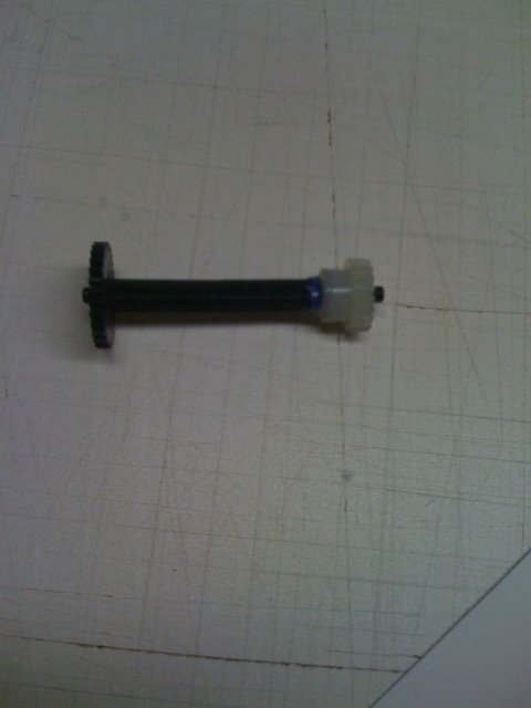

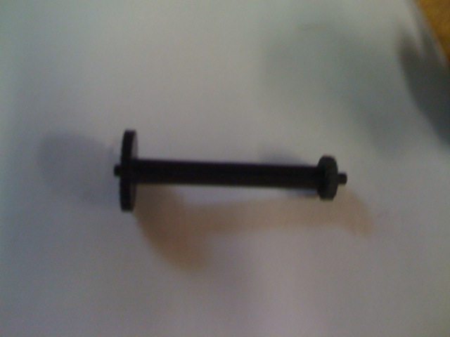

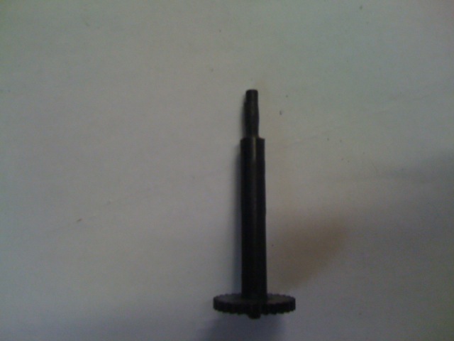

Slack11
The ole DIY worked.... Saved myself 500 bucks.....
I ordered a gear from McMaster Carr (thanks to the link above) part number is 57655K36. I don't think it is an exact match as the old gear, but it seems to work fine. I took the old gear out, dremeled the chewed up gear off and ground down the shaft to be able to fit inside the new gear from McMaster Carr.
I expoxied the gear to the shaft, but left the end "knub" that sits in the holder to allow it to spin and work. This gear costs 2.67 plus shipping from McMaster Carr....A ton cheaper than 500 for the new maintenance station.. It seems to be of a better plastic that hopefully won't get chewed up.
Hopefully this helps someone else, I have spent over a week and a half trying to figure this out, hopefully someone can use this..
