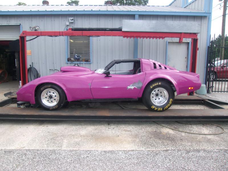

Here is a photo of the car AS-IS now. solid color no graphics on at all. He does not want to paint the car at all..so the current color will be the base color.
The design will cover the missing paint on the door...
