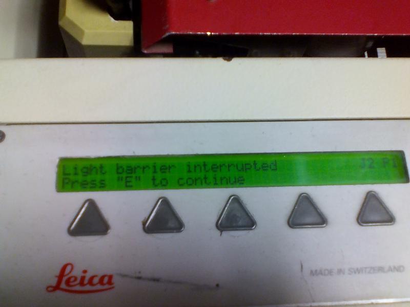

Someone could help TA410ES Wild plotters light gate can be disabled?Thanks for help
photocell is not
scott pagan
the light barriers can be disabled, but you'll need the service mode code to get to that menu. it's not recommended to run plotters with safety features disabled. i would look into why the sensors are not in alignment or what obstructions are in the way.
Laci

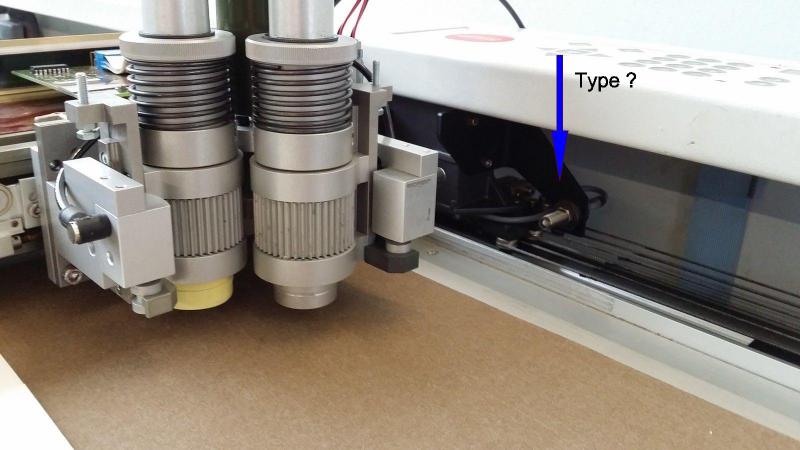

One encoder is faulty. eBay and I can not find anywhere else.I do not know because this is replaced by a test circuit.
I do not know the password Service
