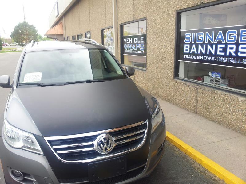

HulkSmash
Here's a hood I recently installed on one of my cars.
Using Knifeless tape.
perfect clean cut.. or i wouldn't use it..
Heck.. suppliers wouldn't supply it if it didn't work.

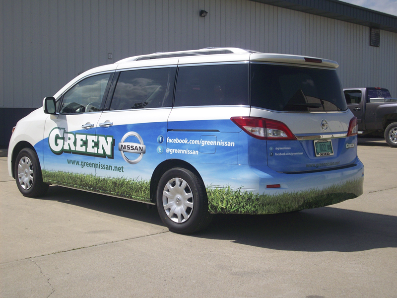

idsignsil
Here is a half wrap we did. We used the knifeless tape on the sides.
