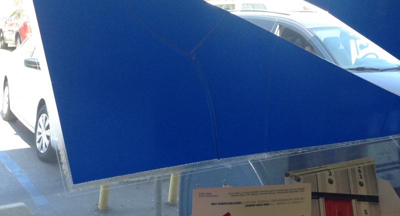

Inside mount lasts much longer around here. The window washers are brutal, the vandalism is rampant, weather is harsh and that is just the first day. It doesn't take long for the vinyl to fail. Some areas are better and you can get away with mounting outside. Inside mounting (reverse) is not as vibrant from the street due to window tinting, dual glazed glass, security film etc.
Absolutely use cast. Even reverse mounted, the glass gets hot when the sun hits it and calendared will shrink a ton leaving a huge glue line or even worse (see photo)

What vinyl is that? I've seen shrinkage, but that looks like it's at least 1/2 inch!
