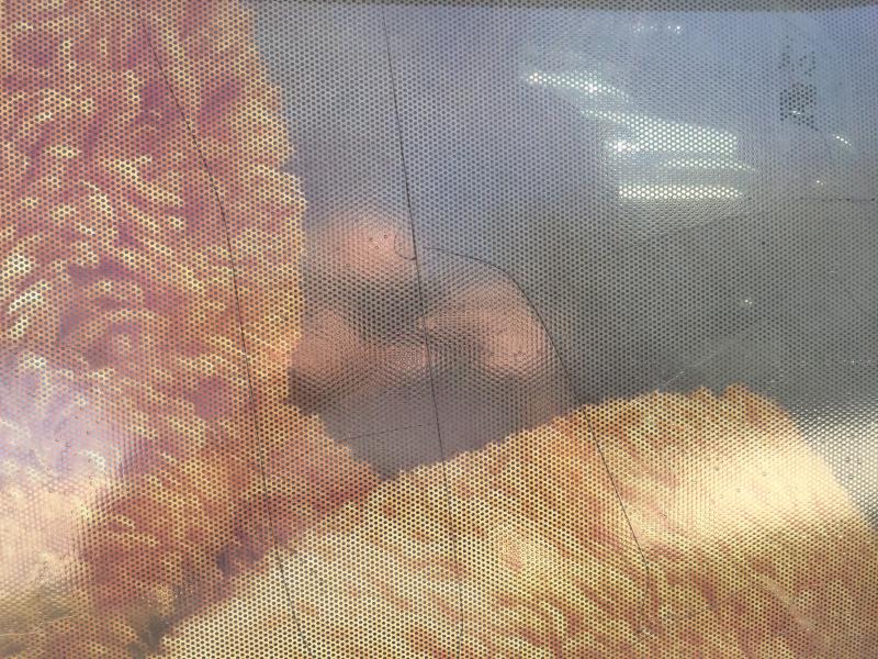

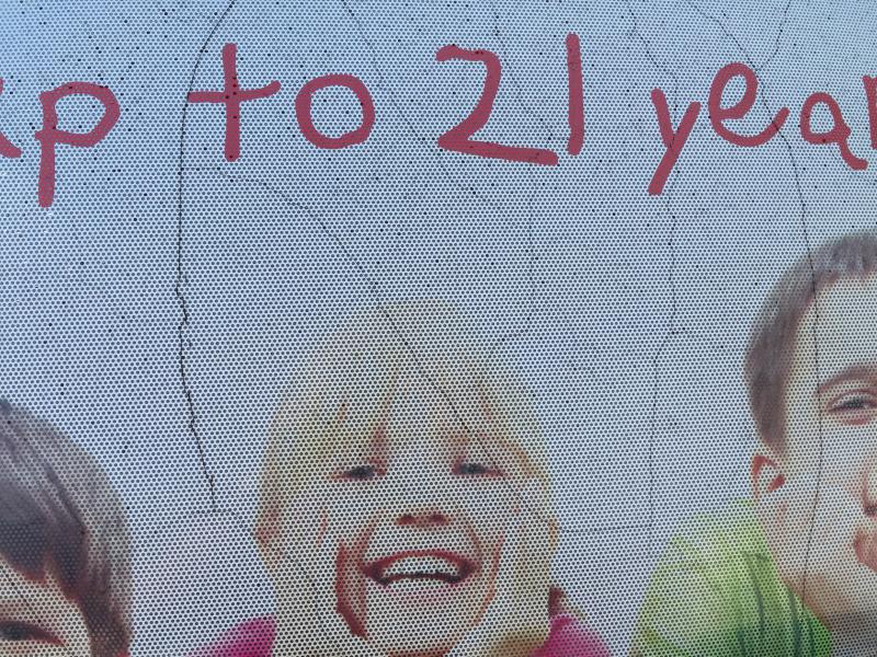

Has this happened to anyone? This is a back window of a van, slightly curved. We used Cast perf, with a cast laminate. Learned that after having to redo it from the first time when the installer got a bunch of wrinkles from the laminate. The cracking in the pics shown happened in a course of 3 months down here in Florida. Never seen this before. It was printed on a HP 360 Latex. Any recommendations, causes?

You didn't specify what brand....never seen this on something that new. Maybe after a few years, in extreme temperatures. We use Clear Focus vinyl with O-290F lam and never have issues.
Also looks like you used a 60/40 perf? Best to use 50/50 for rear windows....easier to see through.

We had the same wrinkling problem as you when we accidentally used optically clear calendered laminate.
I wouldn't expect any cast vinyl to crack like that (someone correct me if I'm wrong), so I'd probably assume the "cast" vinyl didn't come from a major brand.
2B
is it the lamination or the perf that is cracking?
is there any edge shrinkage to make sure you are using cast?
how did the installer get wrinkles? perf is about the easiest material to install there is
DougWestwood
How long was this print left to dry before it was laminated?
Even with HP latex printers, it should be at least 24 hours.
SignMeUpGraphics
Super Active Member
3 months... wow. We've still got some monomeric perforated out the wild 2 years old that still looks new compared to this.
I can't see how cast could do this in that amount of time other than faulty media.
printhog
dis-similar perf and laminate and RainX on the glass.. would explain both the prior issues and this.. It looks like stress cracks - the perf shrunk, but the laminate hasnt. Double check you are using cast perf by verifying the lot number with manufacturer, and use an mildly abrasive cleaner like bon ami to cut the rainX film off.

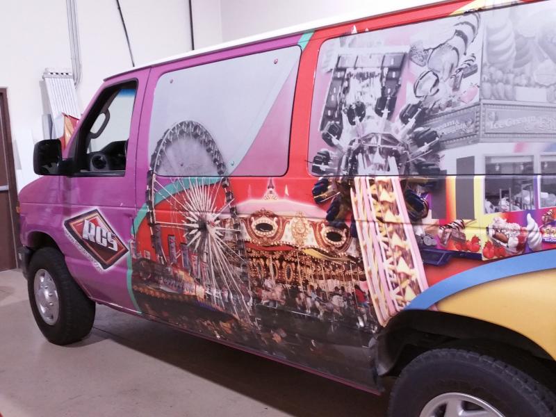

Seeing as I have owned HP Latex printers Since the L25500 was released and was one of the first owners in Arizona, I can attest to the fact that you can literally laminate a print straight off the printer with no adverse effects. We have owned every generation since the 25500. In fact I just removed a wrap that we did in November of 2011 that was laminated immediately after printing.
The most important thing with the HP is to have a good print profile with the right temperatures.
