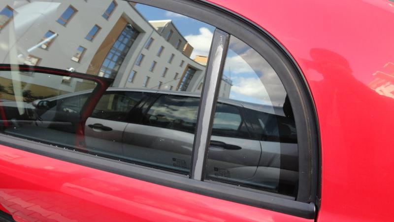

Bit of a novice question really - but when doing a full colour change wrap do you guys bother removing the rubber sills on the outside of the car? I have never tried taking these off before - do they just pop off and back on again? I am referring to the black rubber trims on the bottom ledge of the door windows.

If you are talking about bottom rubber - yes, you just pull it off.
And yes again, if you re doing full color change, you have to take apart everything you can to make your installation easier & ensuring you cover all visible surface.
ExecuPrintGS
Depends on the car and how tight the trim is and how easy it is to remove, every vehicle is different.
If the trim isn't tight to the body we will tuck and cut.
If it is tight we will mark where the trim falls on the body, remove the trim and run knifeless in a bit from our marks sealing with edge seal tape or mold n' hold
