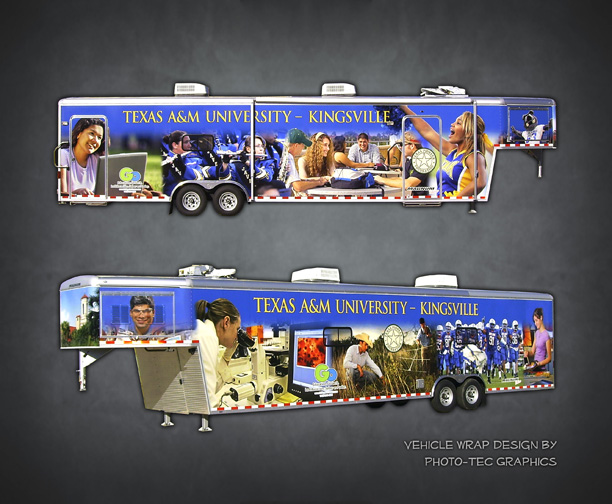

As mentioned already, vector based wrap designs scale to any size without degradation, however if I'm working on a wrap that uses lots of bitmap objects (many photos like example below), I like to do the master layout using Photoshop and create all the text and graphic elements in Illy, and import them into PS as smart objects, so they are fully scalable and stay crispy sharp.
I also like the wrap to look good close up, and keep the PS master layout at 100 dpi, this makes for large working files. I also like to keep each design element on it's own layer, most of my wrap designs have 15-30 layers, again this is the master working file, once the wrap job is finalized and ready to print, I make a FLATTENED production file for printing only (much smaller). I keep the master wrap design as a layered file, and that makes the file easy to edit or modify for other uses or sizes.

TwoNine
:smile:
+1 - Good advice IMO.....
