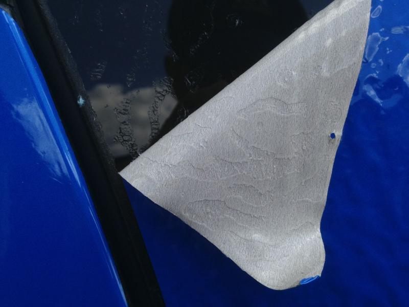

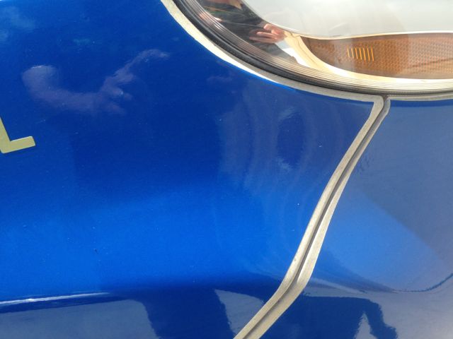

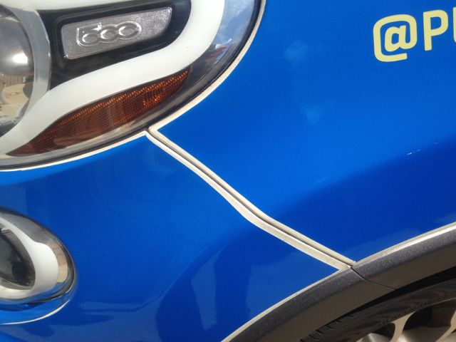

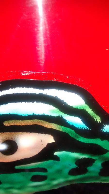

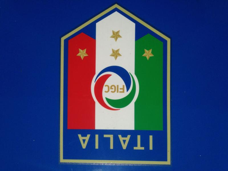

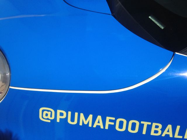

This wrap is about 3 months old. Installed by 3M Certified installers that I have been using for years without a problem. This seems like some type of material defect or something, as it looks like it is shrinking or pulling away from the seems. I've never seen this happen with control tac before so I'm a bit stumped.
HP L26500 Printer
3M 180c-10v3 Control Tac
3M 8518 Laminate
Thanks team!

JoeBoomer
cast vinyl shrinking.....
You'd think the 3M installers would recognize immediately if it was calendered.
I definitely used 3M 180v3 and 8518 laminate. That is pretty much the only thing I print on (signs, decals, everything) due to client specs.
• I have the proof in front of me (printed on same roll) and it looks fine, no visible shrinkage.
• I also have a job that was printed on the same roll and that looks fine
• Even the cut logos on the vehicle have shrunk by 1/4" or more.
Even calendared vinyl wouldn't shrink that much in 2 months. The back has shrunk by almost 3/4"!
Any other ideas?

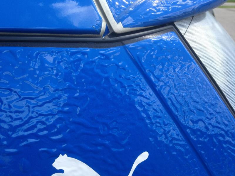

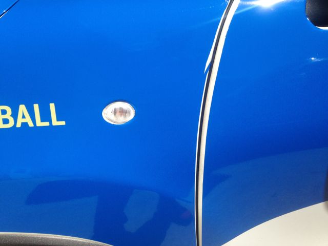

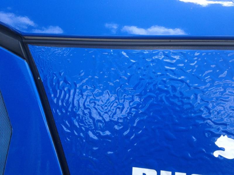

UPDATE:
Check out this pictures and let me know what you think. It looked like it only happened on a few areas on the back.........

This is why I've chosen to use Oracal products more than 3M or any other brand. With over 200 years of German engineering and a company that (as far as I know) exclusively produces adhesive vinyl products it's hard to go wrong.

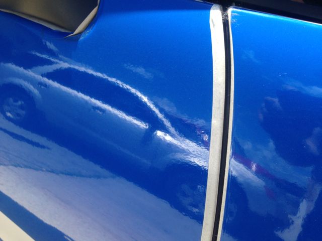

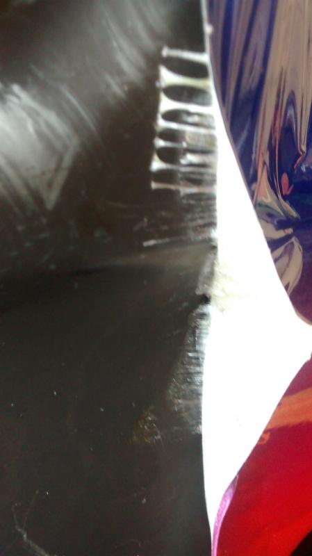

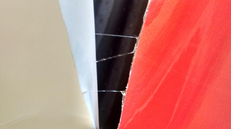

I just went through this with a 25 yd roll. I noticed right away the glue wasn't right and was sticky on the edges and everything I did with it shrank almost a quarter of an inch in less than 48 hours. I took pictures of everything and will be contacting my 3M rep. I may still have to do the whole thing over even though I kept the truck here for 4 extra days to clean the glue from around the edges of a ton of hand cut graphics and reprinted the channels. I've never seen anything like this, even ultra cheap vinyl doesn't shrink this fast! My supplier said they haven't heard of any bad IJ180-CV3. This picture shows the glue line 24 hours after installation.
I thought we paid the premium to avoid this kind of thing?

I had some issues with a roll of IJ180CV3 and received an email a month or so ago from my Grimco rep. Hopefully you have the box somewhere laying around there. Lately I have been having a lot of problems with 3M and their matte 1080 wrap stuff with metallic in it. I have had 4 wraps fail within 6 months and all are different colors. Going to start looking elsewhere for material that doesn't fail so quickly.
Grimco received a recall on the 3MIJ180-CV3 with Lot# F92605 and Drum#’s 001 through 021
Let me know if you need me to send you the recall notice via email.

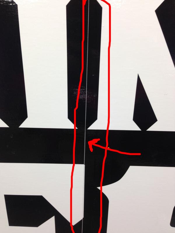

I have been having the same issue with MPI 2105 on signs. Rep is looking into it. Only takes about 2 days to pull back and show the glue.

Here is the actual bulletin...
May 23, 2014
Hello,
3M has informed us of a recall on 3M180IJCV3: 54”x25 yds, 54”x50 yds and 54”x100 yds with Lot# F92605 and Drum# of 001 through 021. If you have any rolls with the specific lot# and drum#, please reply to this email.
  • If you don’t have the box, please check the core. The label should show the same information.
  • If you have any of these rolls, please refrain from using them. Reply to this email and we will replace the roll(s) immediately and make arrangements for the pick-up of the recalled rolls.
  • Rolls that have been installed without any issues will not need to be replaced as there would have been failure during install.
The recalled roll’s adhesive can potentially separate from the film during installation, use, and/or removal. This can cause the graphics to lift and/or leave excessive adhesive residue on the substrate. The defect was caused by an improper setting during the production process. Again, all material without this lot# and drum#’s met 3M specifications.
We apologize for the inconvenience this may have caused you. 3M and Grimco are committed to the highest quality and will properly assist our customers in any event where we have not met our standards.
