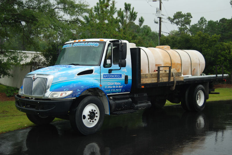

I have actually used 3551 on a few SUV's and big International Cabs and it actually worked fairly well... I haven't heard any complaints from the customers but it did take a little more effort to fit to the curves than the 3951 would have.
Here's a pic of a truck we used it on for reference...
No disrespect to you intended, the wrap and design are beautiful...but this is classic...Much like how Mickey D's makes burgers look sooo much better in their advertisements than they do in your hands...the water in your wrap looks wonderfully delicious...where as, the water in the tanks look, pardon my english like shite.
LOL. I was thinking something similar. That's a great wrap. Too bad the tanks on the back look so dirty.
Excellent job on the design and installation! :cool1:
