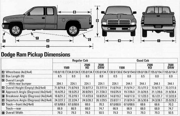

Tons of info on-line for that vehicle if you don't have a camera.
Find the one you want.
Double check some of the measurements to verify the drawing and then go to town.
wayne k
guam usa
