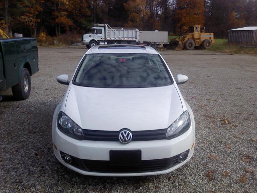

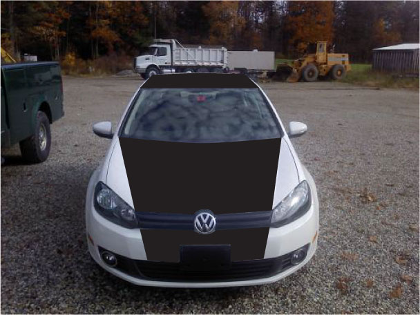

looking to wrap my hood but I want to follow the contour lines on each side of the hood and only wrap the center. What is the best method for trimming to the contours without damaging the vehicle or do you just cut based on the top and bottom measurements and stretch a bit to conform to the contour lines?
Thanks for any input, looking to do this on my new VW Golf.
here's an example that I mocked up on my car:

Thanks for all the input everyone, I do like the idea of wrapping the whole thing as the paint will obviously fade a bit over time where it's left uncovered... I figure if I wrap it with black then perhaps I'll just wrap the edges with white after or have it printed... Prob going to use Hexis 30000 Carbon fiber for the hood and the roof then just wrap the edges with a gloss white to match the existing color :)

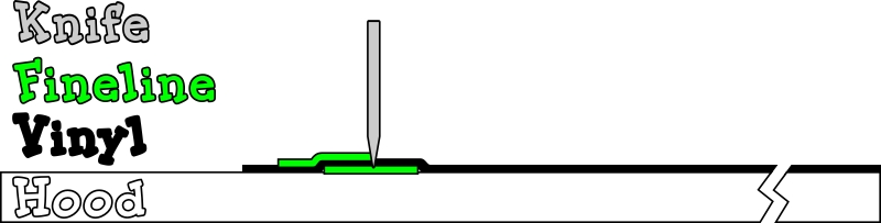

Use fineline tape on the hood before you install the graphic. You can find it at fellers and other places. You'll want to install it in a smooth line centered in the area you want to cut the graphic. Install the vinyl over it. You will be able to see the tape through the vinyl. To cut a nice smooth line, restripe on top of the vinyl with the fineline tape using one edge as a guide for your knife blade. The vinyl won't stick to the fineline tape so it is easy to pull out from under the vinyl, protects the paint and if you can stripe straight your cuts will be straighter.
