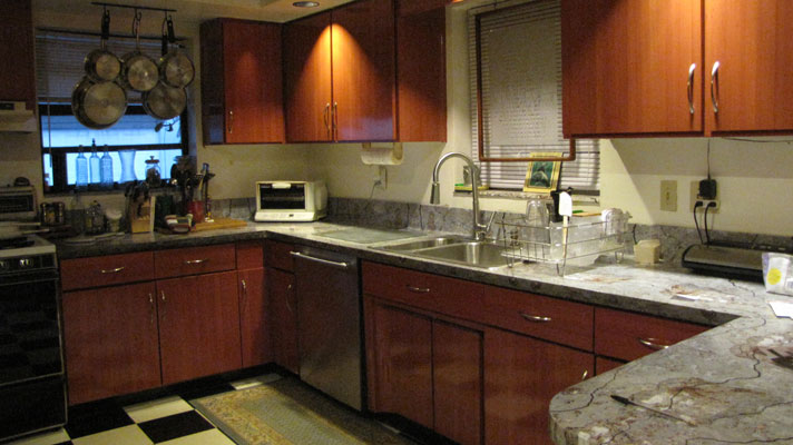

This is my kitchen (my wife's that is) and i removed to doors and bought some European hinges and some mdf and covered everything with Arlon 6000. I did the counter tops 6 years ago and they still look good and i did the cabinets 3 years ago. Wood grain outside with white interiors. the only thing i would suggest is that on the counter tops use some floor lamination to make it last even longer.
Smokin'!!! Our kitchen has seen better days and this looks like the ticket.:thumb: I even have a roll of 10mil embossed lam for the countertops.
That is truly sa-weet !!
