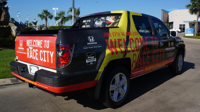

Option 1 - Don't do it. Don't design yourself into that situation. On tailgates, you can often use the tail lights to your advantage in hiding imperfect transitions. Hoods are more difficult. There is nowhere to hide. Save yourself tons of time and don't create a design that requires things to line up perfectly from both fenders to hood.

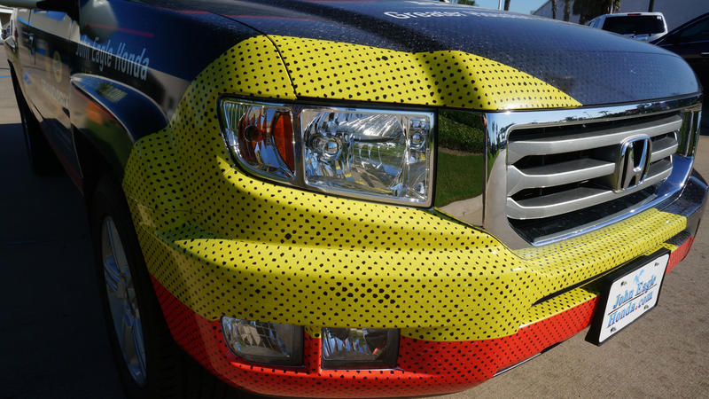

Option 2 - Use overlay graphics. For example, wrap the hood a solid color then overlay spot graphics to line up perfectly with whatever is on the fenders.

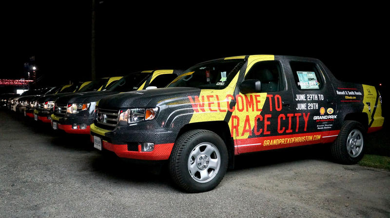

I attached a few pics of a trickier project we did. The designs came from an ad agency. Of course, outside designers have no clue HOW you do it... as long as it gets done. On the hood we used overlays to line up the yellow pieces. On the roof, we built a template so the stripes ran diagonally across and lined up with the stripes on the other side. I don't have a good pic of the roof, but the stripes do line up from both sides.
