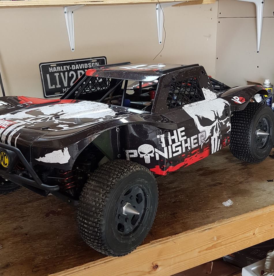

ok, so a growing part of my business is wrapping these high end hobby grade Remote controlled cards...1/5 scale and powered by by 2 stroke engines....
see the pic..

but i digress....some of these bodies like the one pictured are made of rubbermaid type plastics....so normal vinyl doesnt stick....
normally i use laminated hi tac vinyl with full print...but this latest customer wants real carbon fiber wrap..not available in a high tac vinyl..
My question is simply this....can i coat the rubbermaid body in the 3m adhesion promotor and use the carbon fiber vinyl...or do i need to primer the body with the hi tac vinyl and then cover it with the carbon fiber?

those trucks are about 3 feet long for a size reference
design is usually 1-3 hours....and i don't usually install them myself, (well, some i do like the pic above)...i usually just ship to the customer and they do it.....
