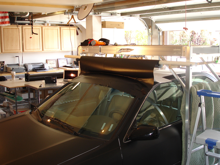

I wrap alone, magnets are great, but when it comes to the top, i don't have much of a reach. Here's a pic of my solution to doing the roof without an extra set of hands... set up a section of scaffolding spanning the car, tucked a hockey stick in either side to hold up pvc, and just rolled the vinyl off as i went... looks funky, but worked pretty darn well.
Rooftor :ROFLMAO:R
ROOFTOR(tm)
Yep, that's the one. The body kit bumpers turned out to be a frigg'n nightmare... that's a story for a new thread. I'll post the story and pics next week.Is that the flat black wrap on the camry you were talking about in your other thread? Looks like it is coming out pretty well!
