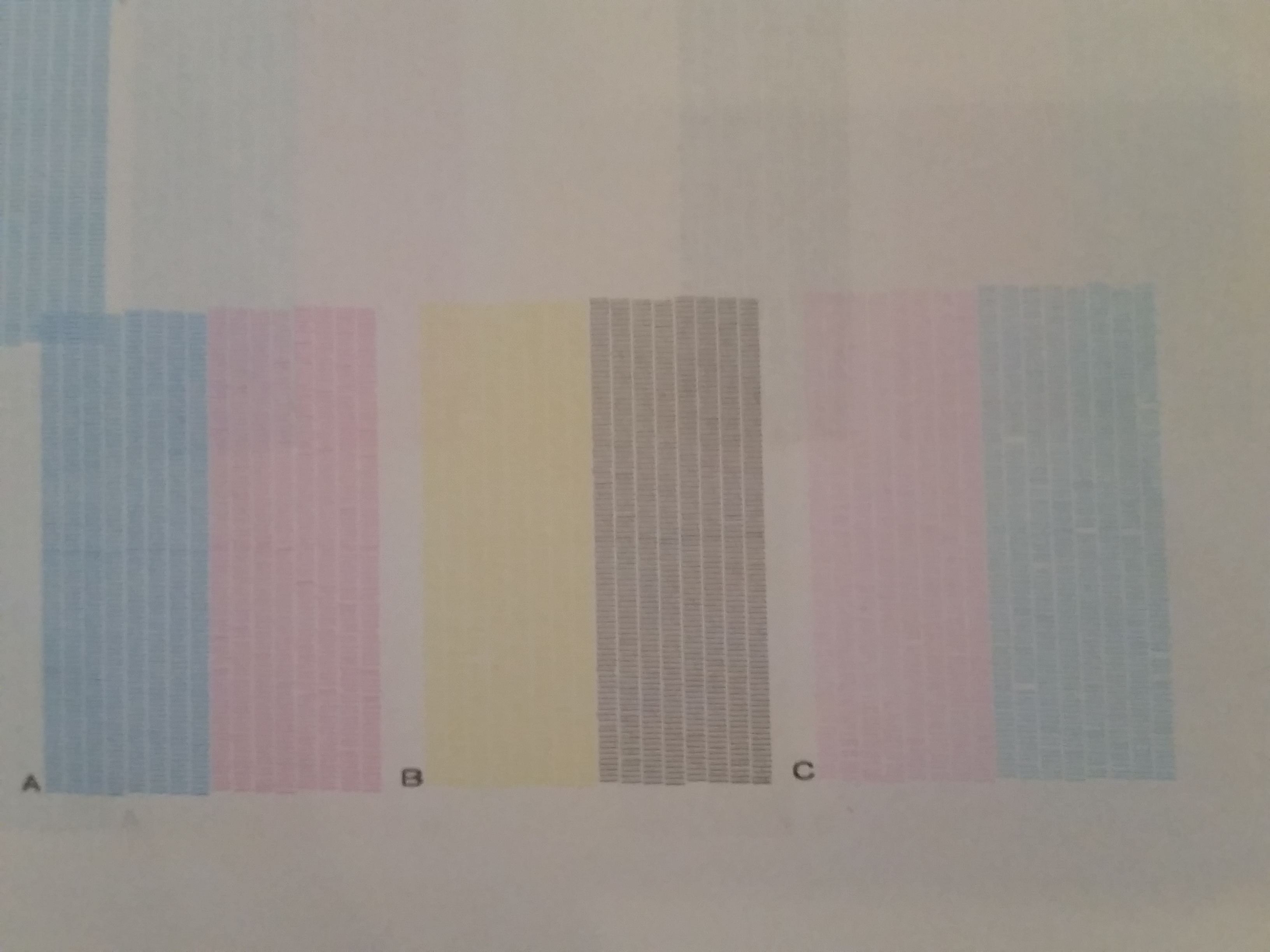

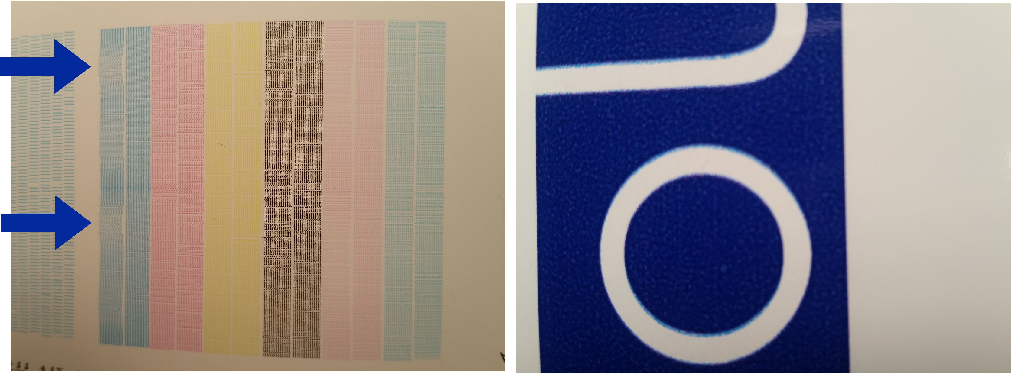

This test print is from the service mode more detailed. As you can see there are waves in the Cyan causing slight blurring in actual prints. Fix? or head replacement. Fairly newer head about 9 months no strikes.Regular test print looks good.. any help?

Based on the photos, you can try executing the printer's User menu "Factory Default" to see if that helps in any way. If not, then it's out recommendation to contact your authorized Roland dealer to fix the printer.
If you have additional questions or need extra support directly from Roland corporate support, please submit an "official" support request form online here: Product Support Form | Roland
If you do write us, we look forward to helping you and take care,
