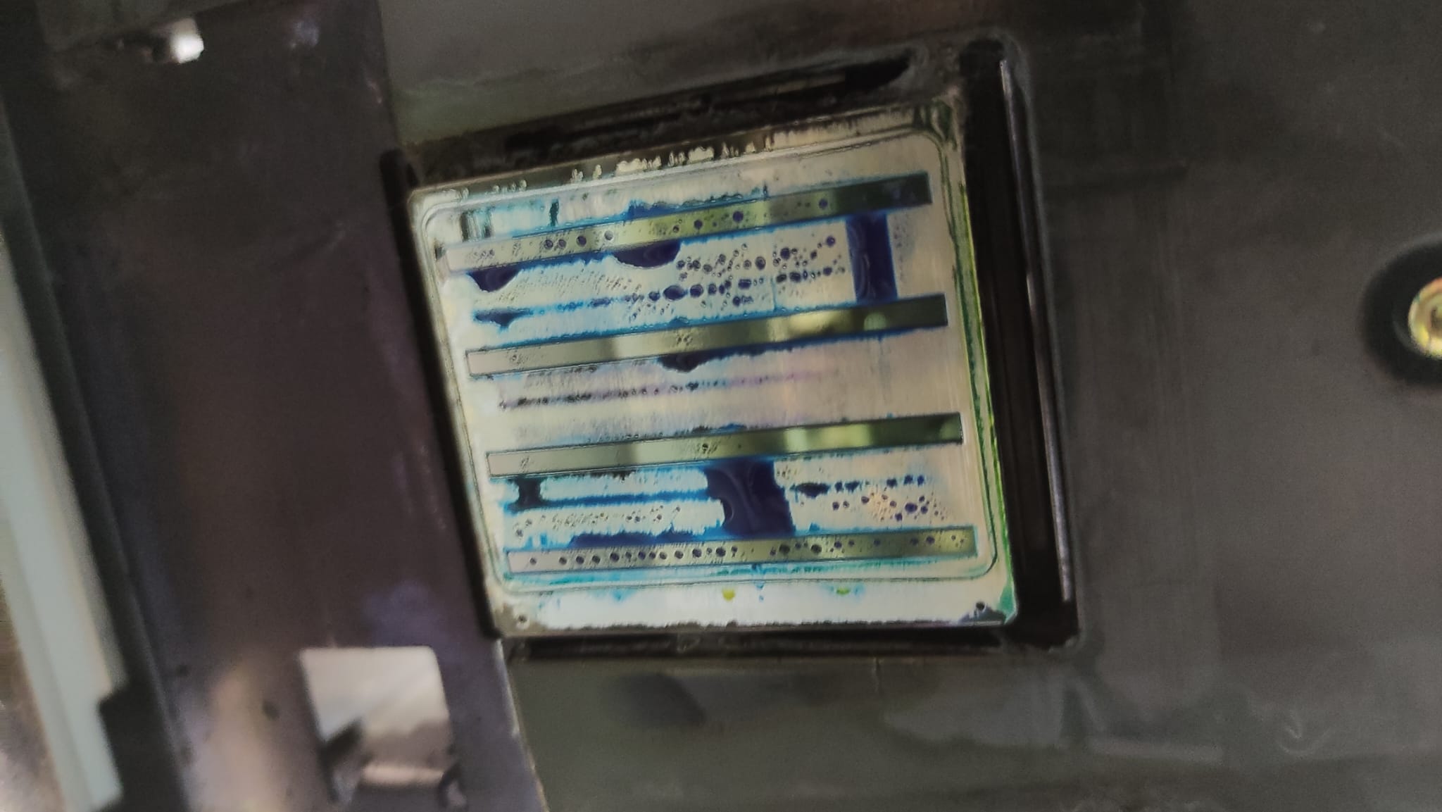

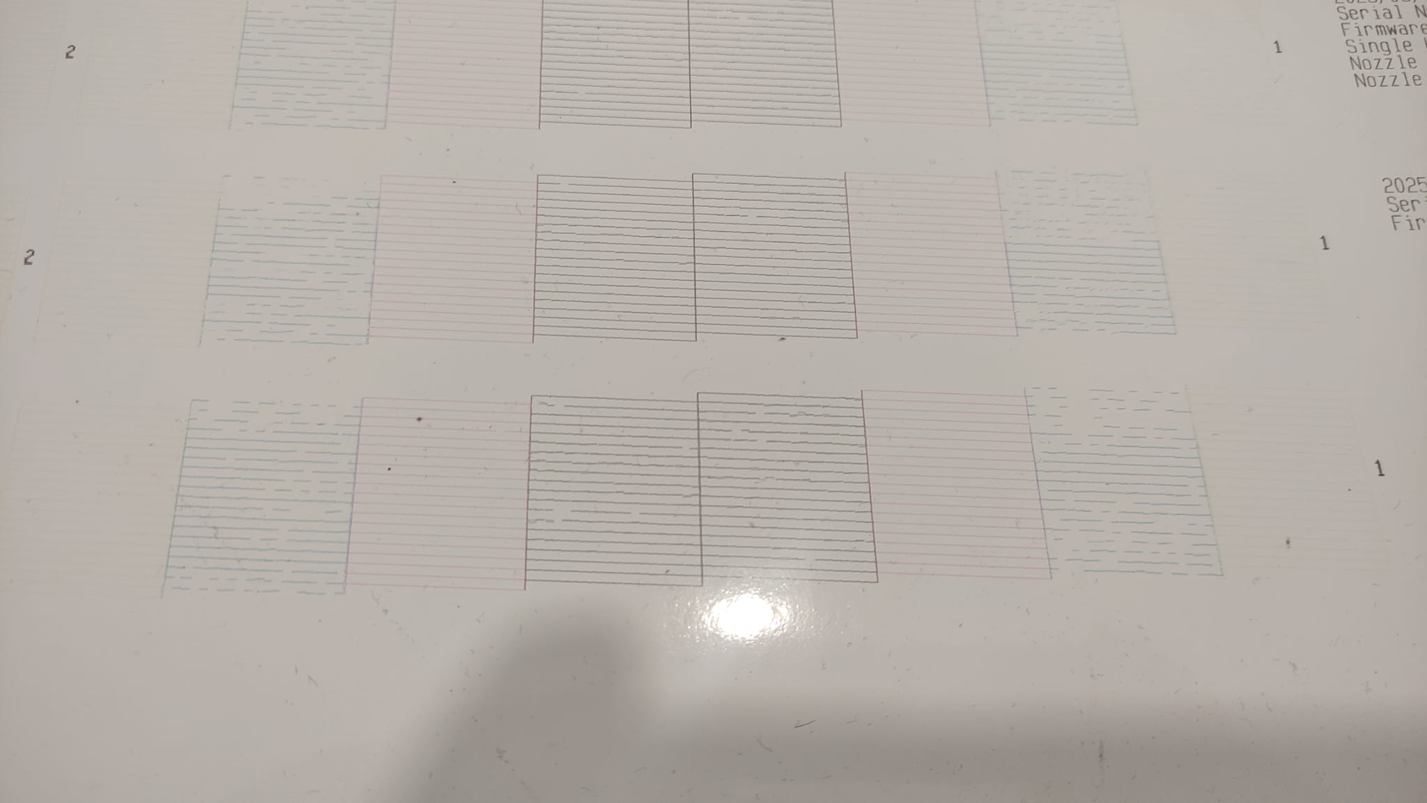

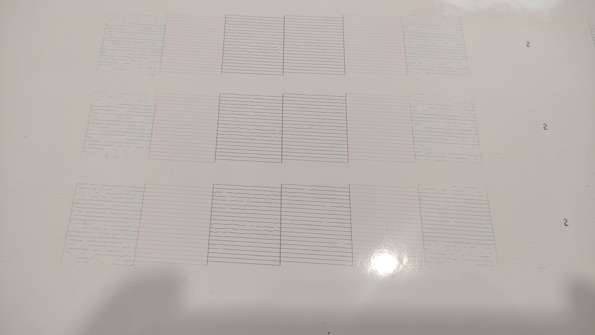

hello everyone. my 2 years old 1682 srp started loosing cyan noozles during print, few weeks ago. at first it was not a big deal, it was recovering after a short cleaning. but after a while the problem got worse, loosing noozles much faster, and recovering much harder. so i started changing head cappings with al tubes attached, dampers, wiper, and one of the printheads, with no success. now i cannot recover a full channel of cyan, none of them are good. and after every cleaning the printheads are flooded with cyan ink.
any ideas?

Classic damper issue. If it sits for awhile it will recovers somewhat but drops nozzles again when printing
Emil M
i changed them already, twice on printhead1. first just dampers, then one more together with the printhead
