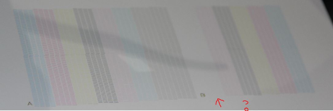

So one of my rolands is giving me trouble. Both are getting a bit long in the tooth so I figure I probably have a bad head...but I'll take any advice if someone has a solution. I've already cleaned the head, checked the ribbon cables, looks like the head is attached to everything properly...I've been having some issues with blurry prints with small type too but I could squeak by until now. Now my colors is all thrown off...wish I could just disable a head and keep rolling but alas...I lack that kind of know how. Any help appreciated!

I wouldn't be surprised if there was air in the line. It's probably a bad damper or air leak. Make sure the lt cyan cartridge actually has ink in it. Sometimes it will not flag properly and cause pull back on the system.

Ok, so the dampers are a completely different style than I've dealt with: they are on the head itself and require you to take apart the top of the head to get to them....I'm being told by 2 techs that changing them requires you to "chuck the heads" since they're under pressure or you get a mess all over your electronics. I'm sure that process would be a bit much for me....Fantastic, thanks Roland for yet another fun feature you've made impossible to fix without a tech... but I guess techs gotta make a living too....lol..

To get around that, you can drain the lines, that way there shouldn't be much of anything left in the dampers, although I recommend flipping it upside down when removing so if there is any spill it will fall away from the head, but at that point, you might as well just change the dampers afterwards.

Not sure if you can do this with the XR-640 or not, but you might be able to connect a syringe to the line after the cap top to see if you can pull ink through before you go through the process of replacing the damper.

On the older ones, yes. This one....can't even get at the damper without some pretty extensive teardown by my non-tech self...I like to older simple systems were you could actually tear in and have a change at getting somewhere. I have a couple hunks of junk I run and at least I can keep the old stuff going... not well, but going!

Without touching the dampers right now, can you get access to the lines after the cap tops? If so, you can un-connect it from the pump and connect a syringe to that line and see if you can pull ink through, that is a good sign that it's not the head and that it's most likely the damper that needs replacing.

Have you cleaned the dried ink off around the edges of the cap tops recently?
