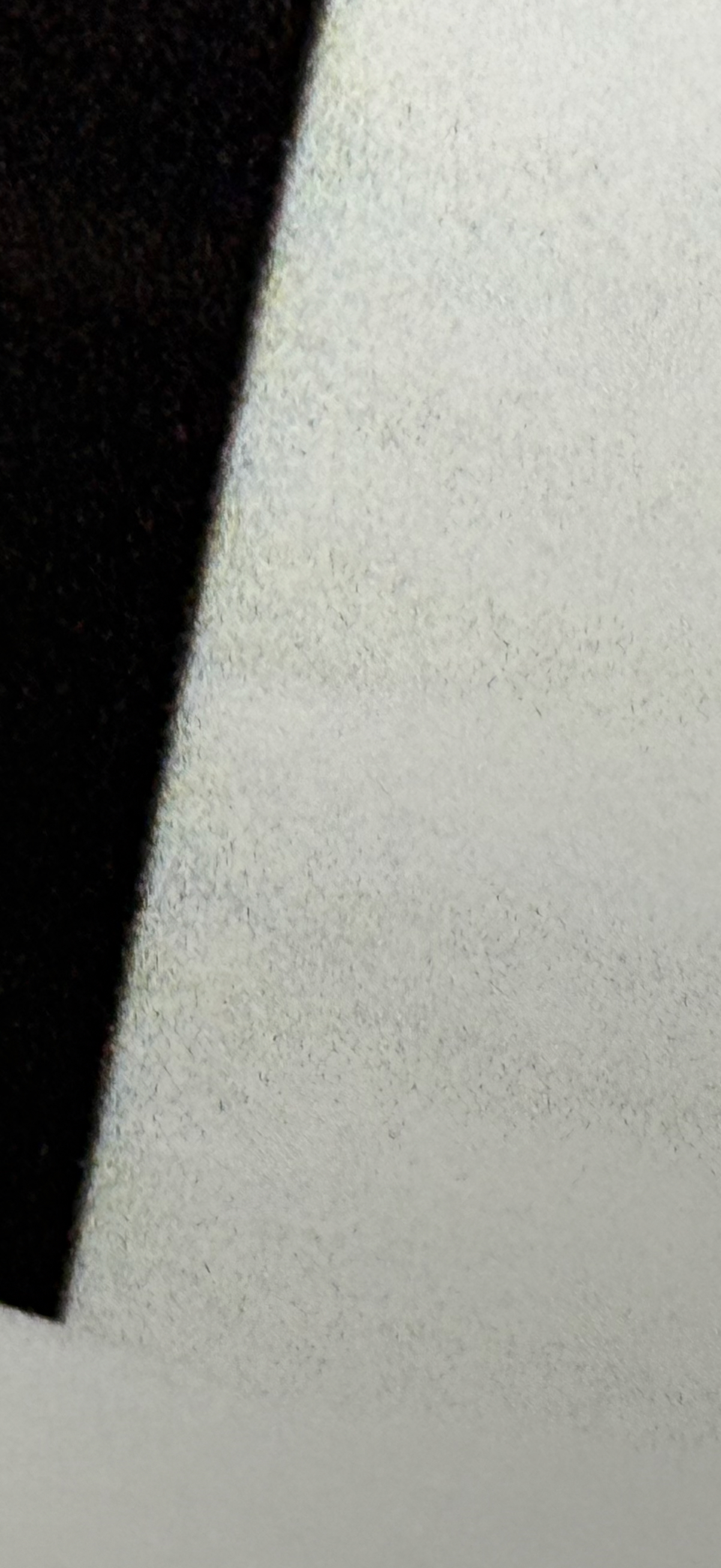

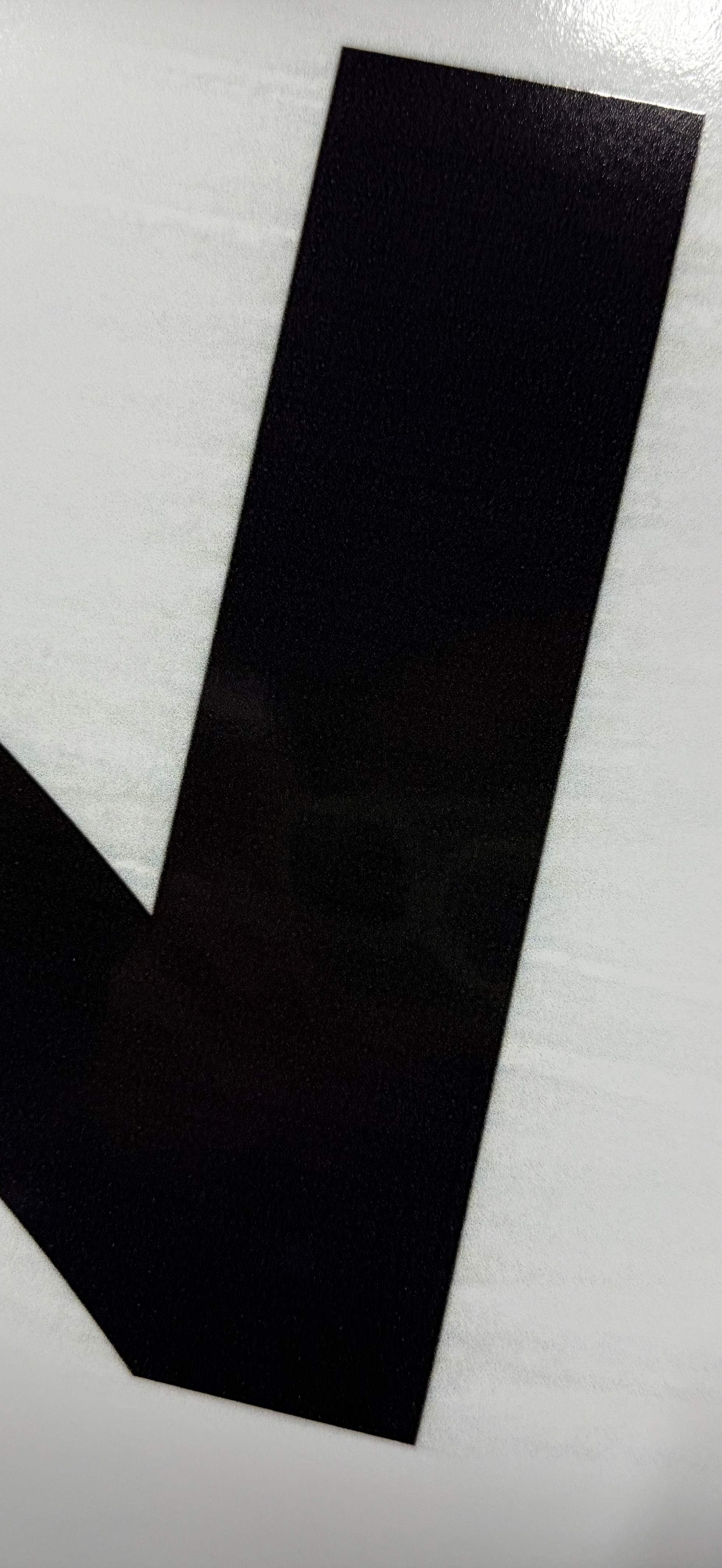

Lately, I’ve been noticing a lot of misting/overspray on all my prints. (see attached).
I know this photo is only showing black, but it also happens with cyan as well.

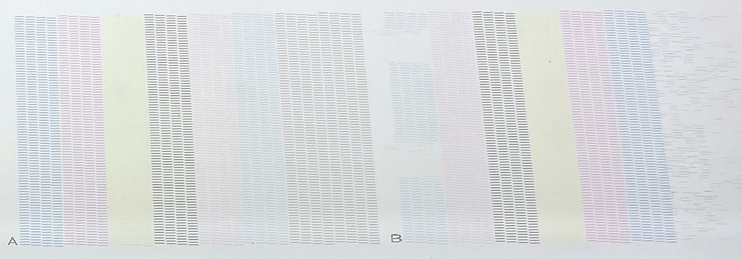

The nozzle test print is usually almost perfect minus a few missing lines here and there, which end up correcting itself after a standard clean cycle.
Disregard the 2 huge missing sections on the LC (it went away after a manual maintenance cleaning). I'm using this photo to show all the random lines where the white ink used to be. (currently have a cleaning cartridge in that slot). This is the worst case I’ve seen. 3/5 times there's nothing and normal, 2/5 I’ll get some random lines here and there.

I'd start by cleaning the encoder strip first, as I don't really see any deflection in the black nozzles, maybe a test strip in service mode with the smaller detailed view may show more.

Check to see if the white is clogged at the head, then you know if you need a head.
Yes, you need to check complete ink system for the white from the I/C holder to damper and the recirculation line and recirculation pump.
Then you will know what you are dealing with in terms of parts that need to be replaced.
