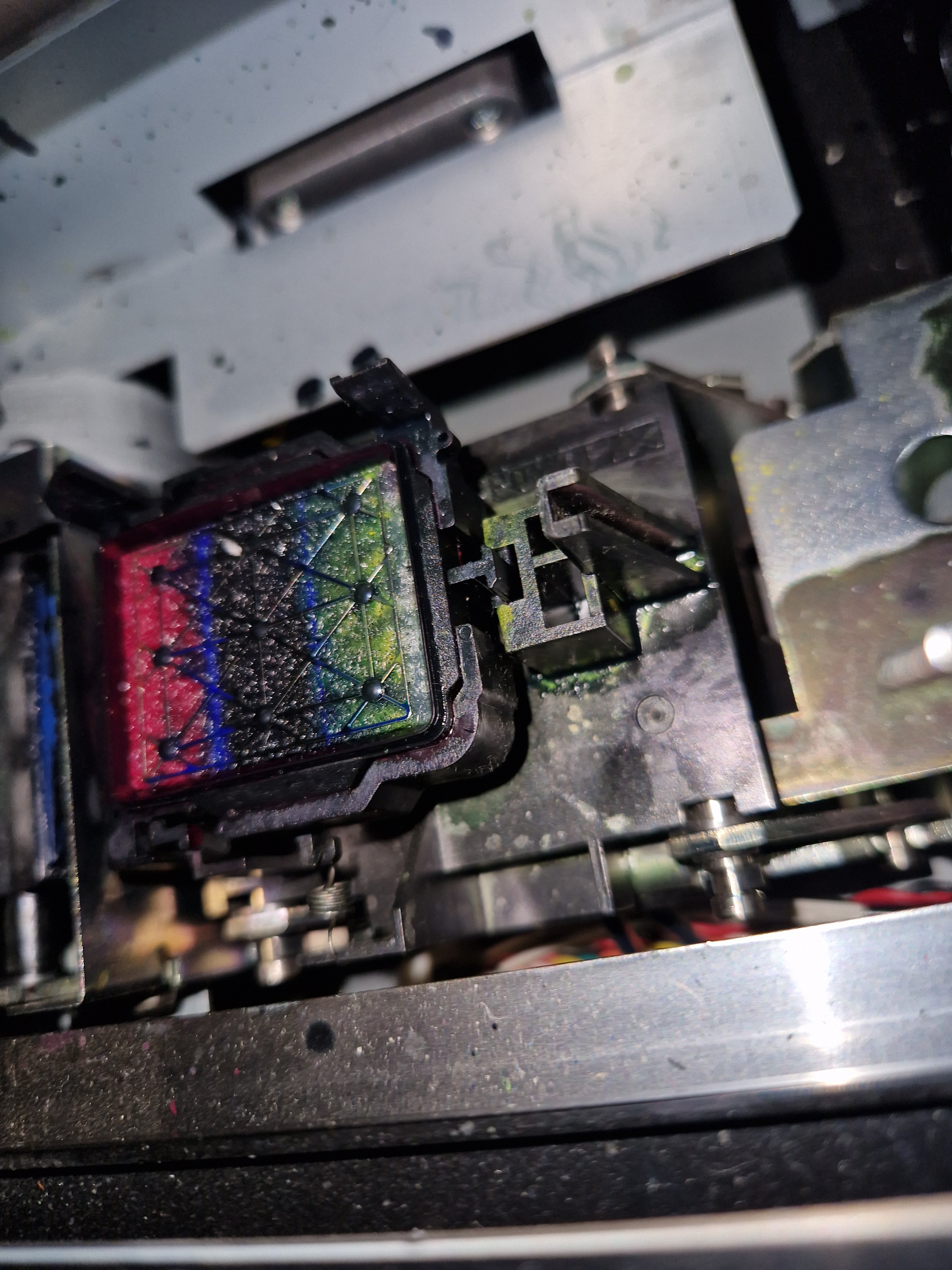

Hello, I have a problem on my Roland BN20 printer that I can't solve... the yellow ink doesn't come out at all most of the time, so far I've already changed a LOT of parts but the problem persists... I've already changed :
- The print head
- The 4 flat cables of the print head
- dampers (several times)
- the cap-top
- the connection between the dampers and the ink tubes
- the entire ink circuit (hose, seals, brass screws)
My printer is set to CMYK+Mt, but I use a cleaning cartridge instead of a metallic one, and my ink has always been Eco Sol Max 3 ORIGINAL.
After checking, I notice that there's a bit of liquid/ink on the edges of the cap top (see photo), do you think it's defective? I had the same problem before changing it... I changed it thinking it would solve the problem at first...

There are bad Max3 yellow cartridges. When I started having those issues with several customers, I switched then to Max2. I never had issues with Max2.
sekorse
Hello, I'm on my 3rd different cartridge from different suppliers (new), and the problem persists, although I've never had this problem before and I've always used EcoSol Max3.
