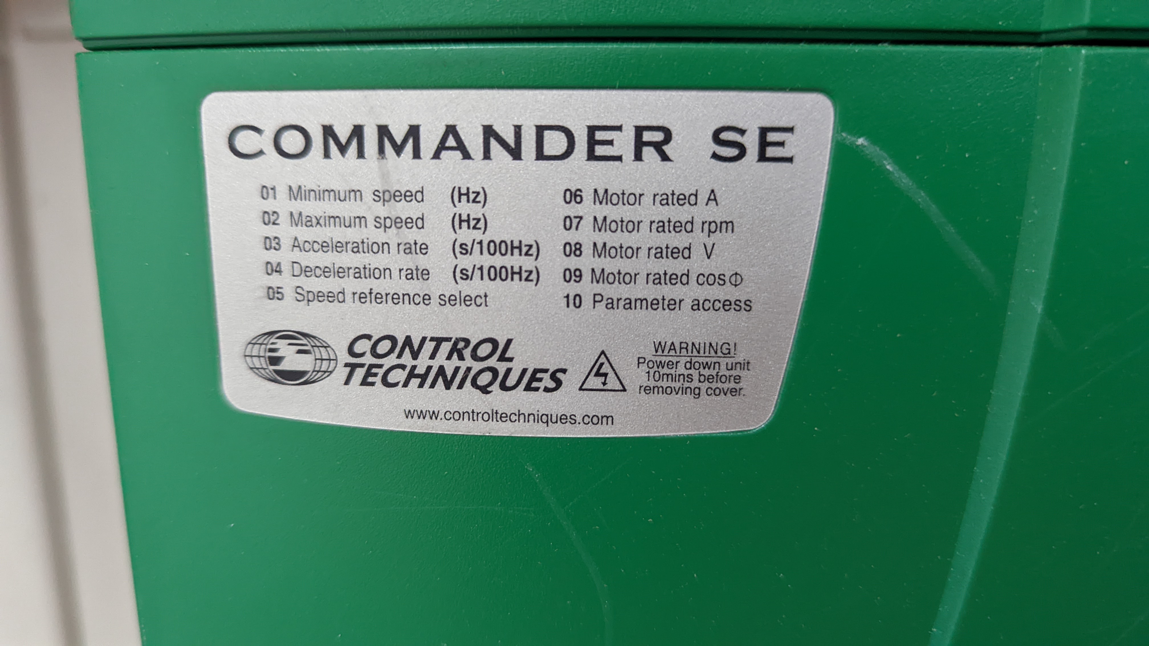

The issue I had today was when we turned on the machine it powered right up, but did nothing after that. The control Pendant lights up and says "Operator Pendant Rev 2002A. I tried checking the fuses and they all seem to be good,. Any insight or suggestions would be greatly appreciated. It has the spindle controller COMMANDER SE. I was able to go into the setting on it and turn on and off the spindle(but in doing so messed up a few settings), so now when I turn the machine on the spindle turns on and I have to hit the stop button on the Commander control.

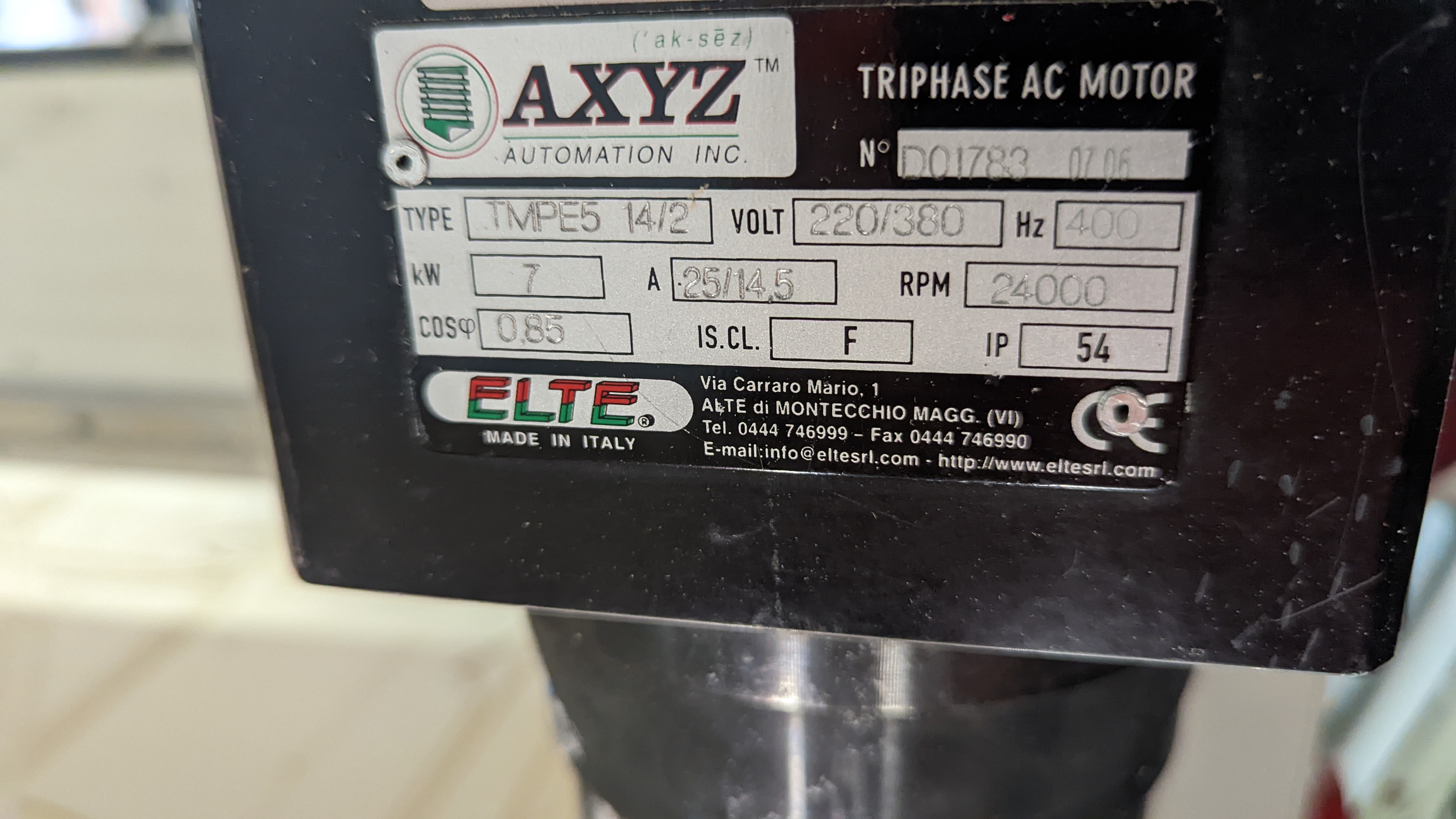

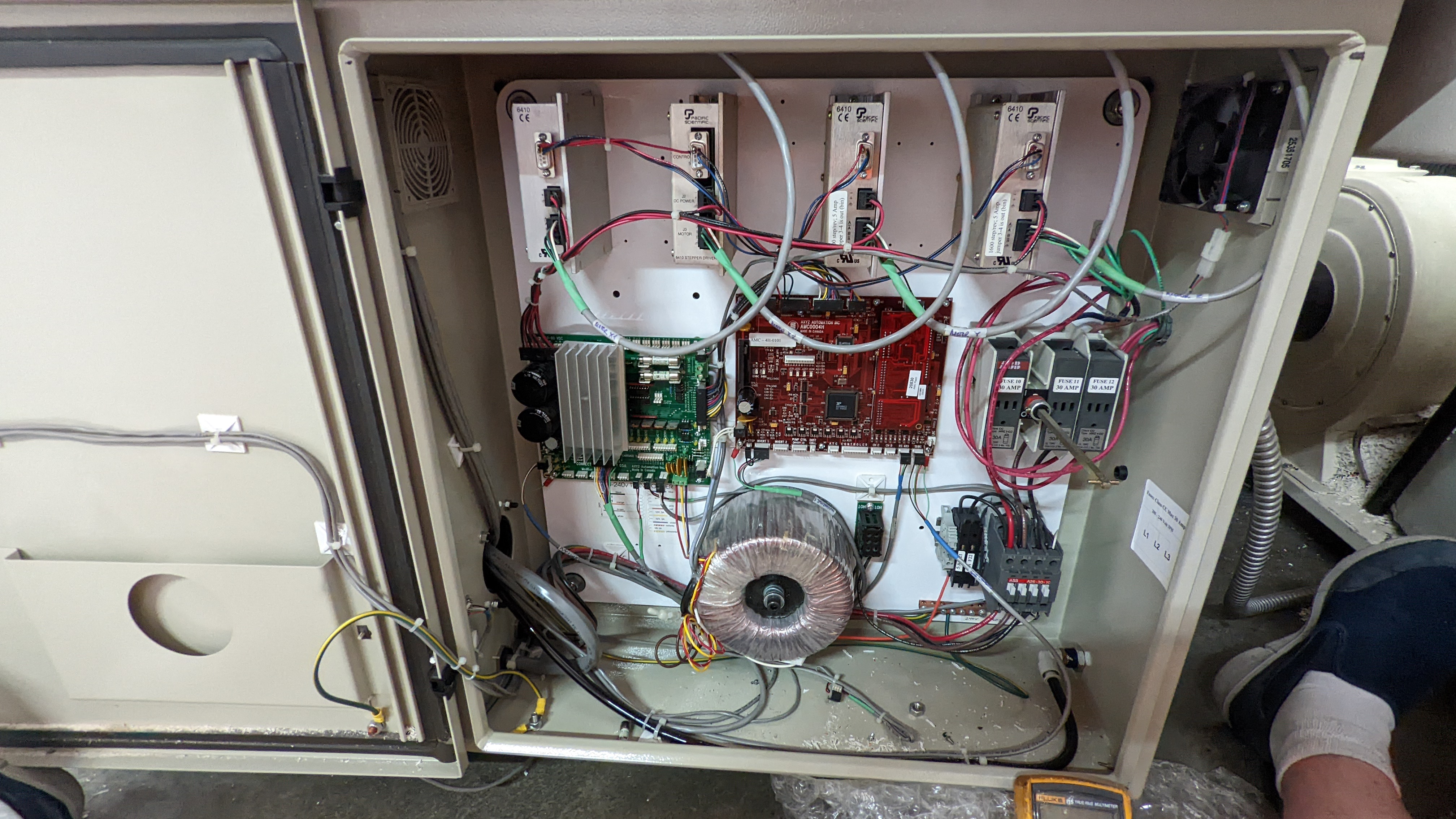

Thank you! I actually replaced the AMC board today and that appears to have been the issue, but unfortunately I had messed with some settings on the commander se and not sure if I have them reset back to where they were. So if anyone has any insight on the settings I would greatly appreciate your assistance
