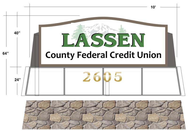

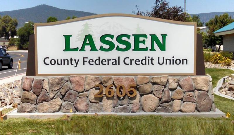

Heres our latest - aluminum base with cultured stone, LED lit double faced lightbox on top - ~5' x11'

I like the side pieces as it gives it a nice shape. is that cladding or something else? also love the faint trees in the background. looks nice

The shadow on the main copy doesn't match the one under the numbers on the bottom.......
FS-Keith
Looks nice, do you put lathe on the wonderboard or are you just mortaring the stone onto the cementboard? I would be worried about that being so brittle and cracking especially since you are building those in the shop and transporting them like that?
J Hill Designs
built on site. I have many jobs new and old using the same technique. No issues.

Really Like This One Alot.
I really like this Job a lot!!! Everything about this design is attractive...the Green color used in Lassen, the recessed/ 2 layer cut out, the font styles, the perspective you gave the stone and I especially love the subtle (watermark) approach you gave the trees and mountain side in the background of Lassen. Great Job!!!!

ok i thought you where building in the shop and transporting. We build ours in the shop very similar only using alum angle framework skinned with dibond and lathe screwed overtop, then do our stonework. transports well, they just get heavy sometimes.
