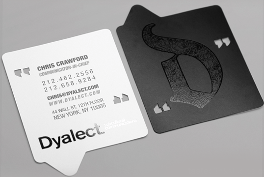

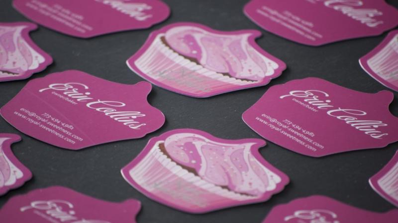

I'm looking for a mid-range die cutting machine that I can do custom cuts. I have found small end machines such as this but I doubt it could handle up over time or cut around 100lb stock.
  1. Anyone familiar with a mid range die cutter?
  2. Anyone used any rip software with a die cutter?
EDIT: does anyone have another alternative to do custom card stock I am open to ideas. thanks
MatthewTimothy
No sadly I am not. I need to find a solution that I can use to do something like this for someone and I have no clue what to look for. :banghead:
If I can find anything better I am all ears!

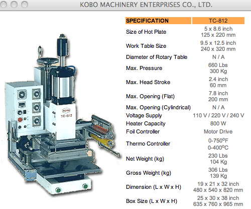

I have a lightly used foil stamping/embossing/die cutting press for sale. It is very powerful. It would cut through any stock you might want to use. Even has a semi automatic mode. It has been sitting covered for a couple years so it needs fresh air tubes and an inexpensive compressor to operate. You have to buy dies in whatever shape needed. I paid $4500 for it new. Asking $650. Problem is shipping as it is very heavy. Would have to be crated and go by freight, or picked up.
