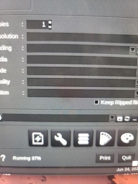

has anyone ever seen this happen? I loaded in a job and went to select my settings and all the text is missing. everything has been printing fine with all of the correct settings but no read out in the module.
any help would be great,
I run on Caldera 15

I'm sure you figured it out by now but it was a XQuartz version upgrade that caused this on my Mac. After downgrading it returned to normal.
