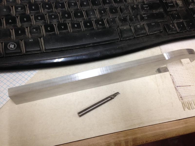

Here is my cutting setup for cnc router. Thickest aluminum I am usually cutting is 0.5 5052.
Spindle water cooled 3kw.
Endmill single flute O flute. 110ipm 24000rmp
0.65-0.125 per pass depends on shape of the part.
Cold air gun ON,
dust collector ON 1" above cutting material.
Before cutting I apply PB blaster to entire surface of the aluminum
