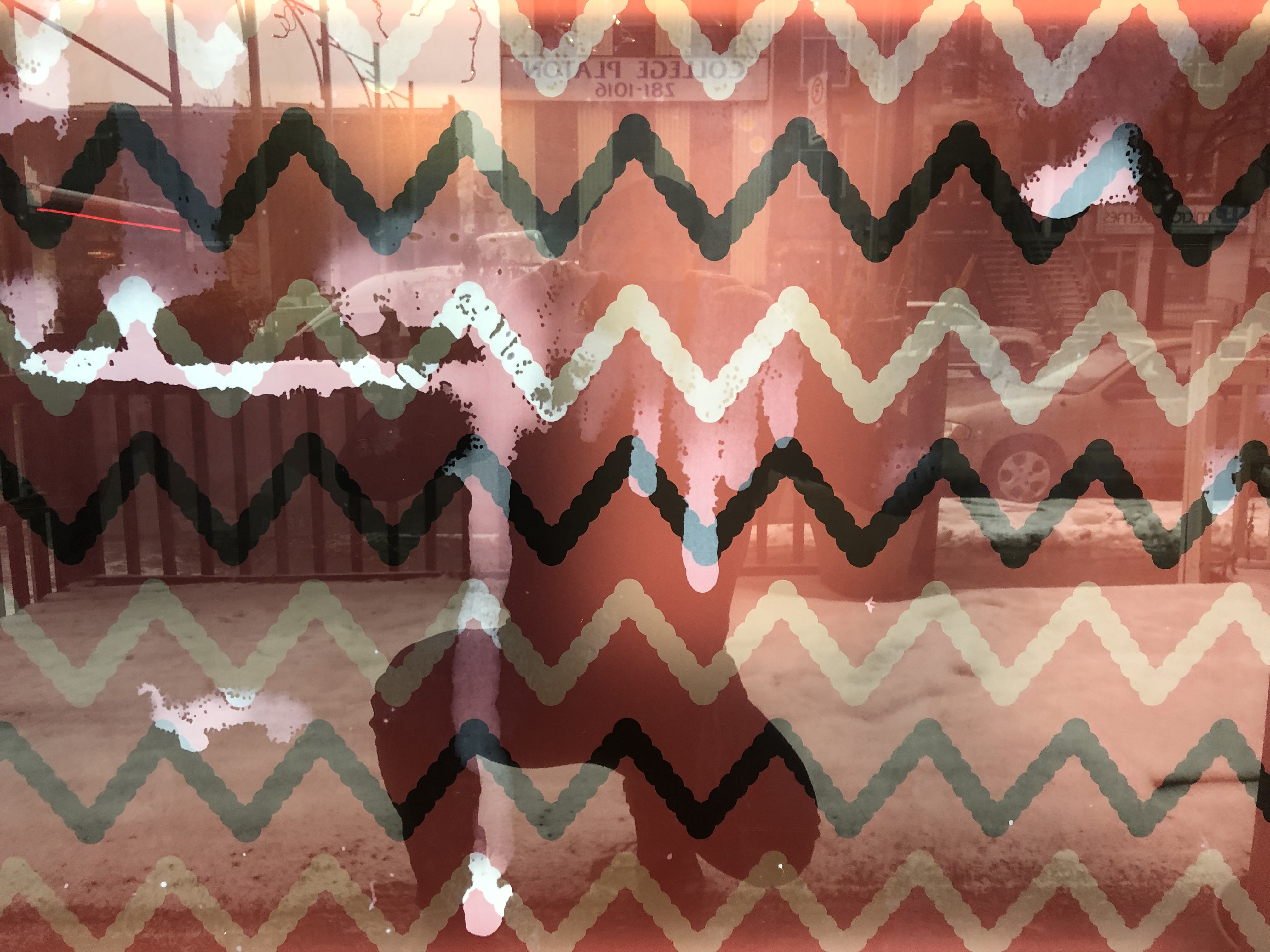

Hi,
Here is the result of a Wet installation of a vinyl oracal 3621 Clear with lamination.
Can somebody help me?
Do you realize, that series is a water based adhesive ?? Not meant to be put down wet. You've basically destroyed the adhesive
a77
I do think it will clear up a bit. Probably won't be perfect.
3651 clear is what you wanted to use.
