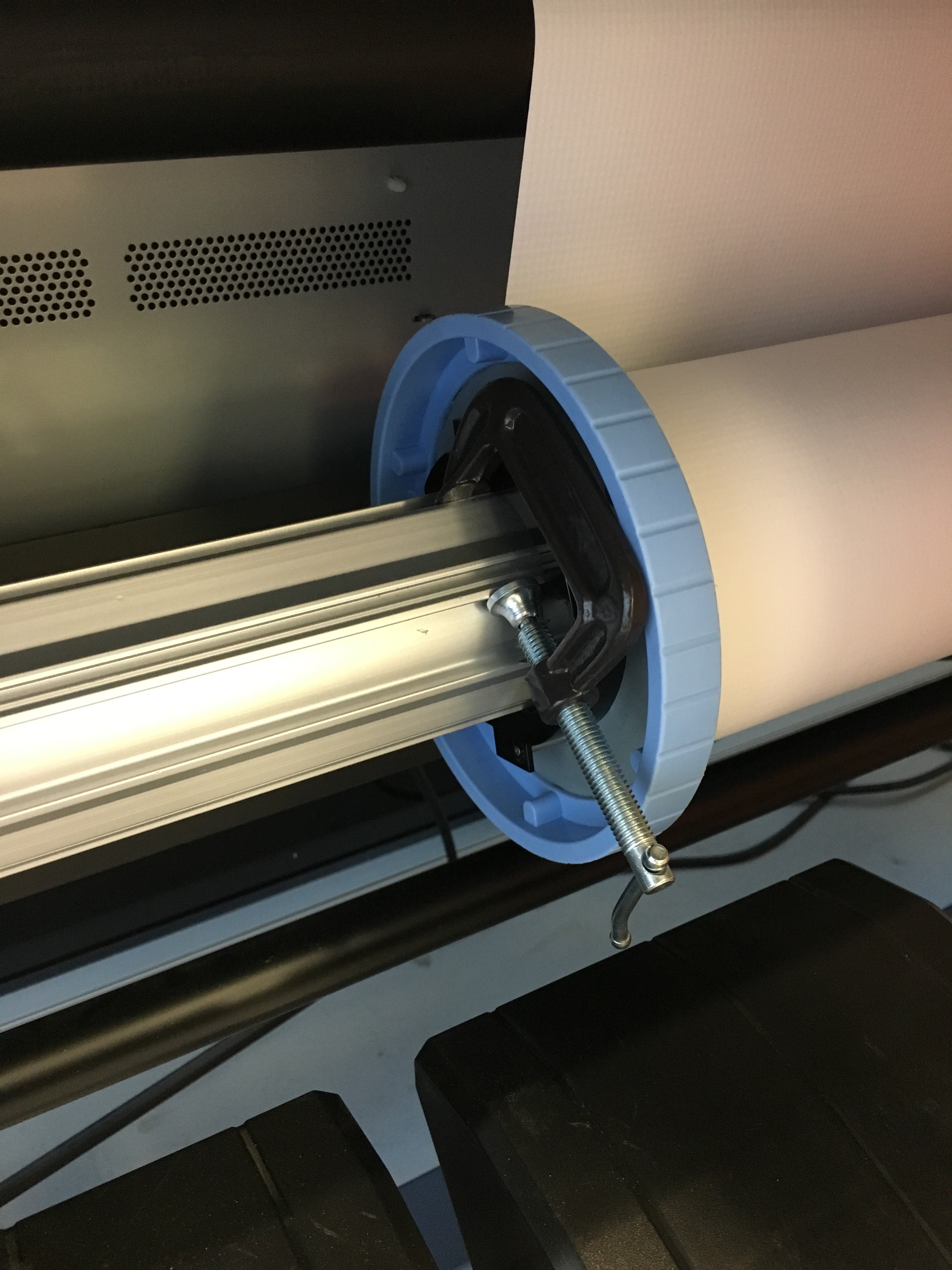

I have an HP Latex 360 and also have the issue of my material being pulled and skewed out of place into either direction. I have found that the blue end caps for the spindles do not clamp on to the spindle well enough to keep the roll from moving. I usually put a clamp down on the spindle to make sure my roll doesn't moving at all, which in return has kept it from skewing since.

I just place a clamp directly next to the spindle cap on the main spindle and the take up reel to ensure minimal moving of the roll.
