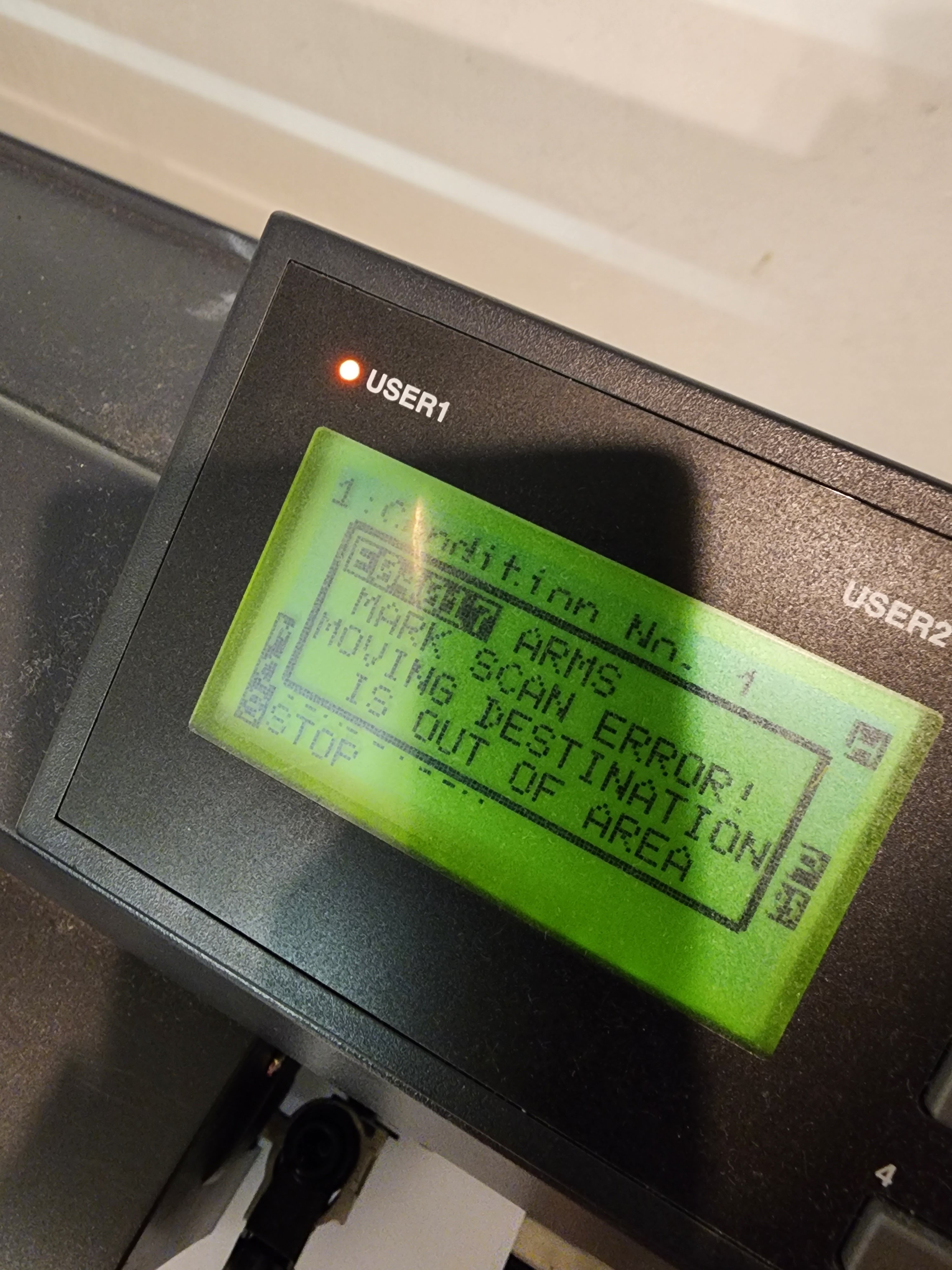

Using flexi and contour cutting on a pretty thick material with a q54 cutter...while setting the material...it goes crooked and is not picking up the back contour marks....any help appreciated...I have tightened rollers as tight as I think they will go

So i just read that the q54 doesn't contour media thicker than 0.3mm and looked my material up and it says its 6mm BUT i have cut it before.....can I get around this???
EVERY TIME!!!! I AM SO MAD....I HAVE DONE THIS A THOUSAND TIMES AND IT ALWAYS WORKS...NOW THIS
