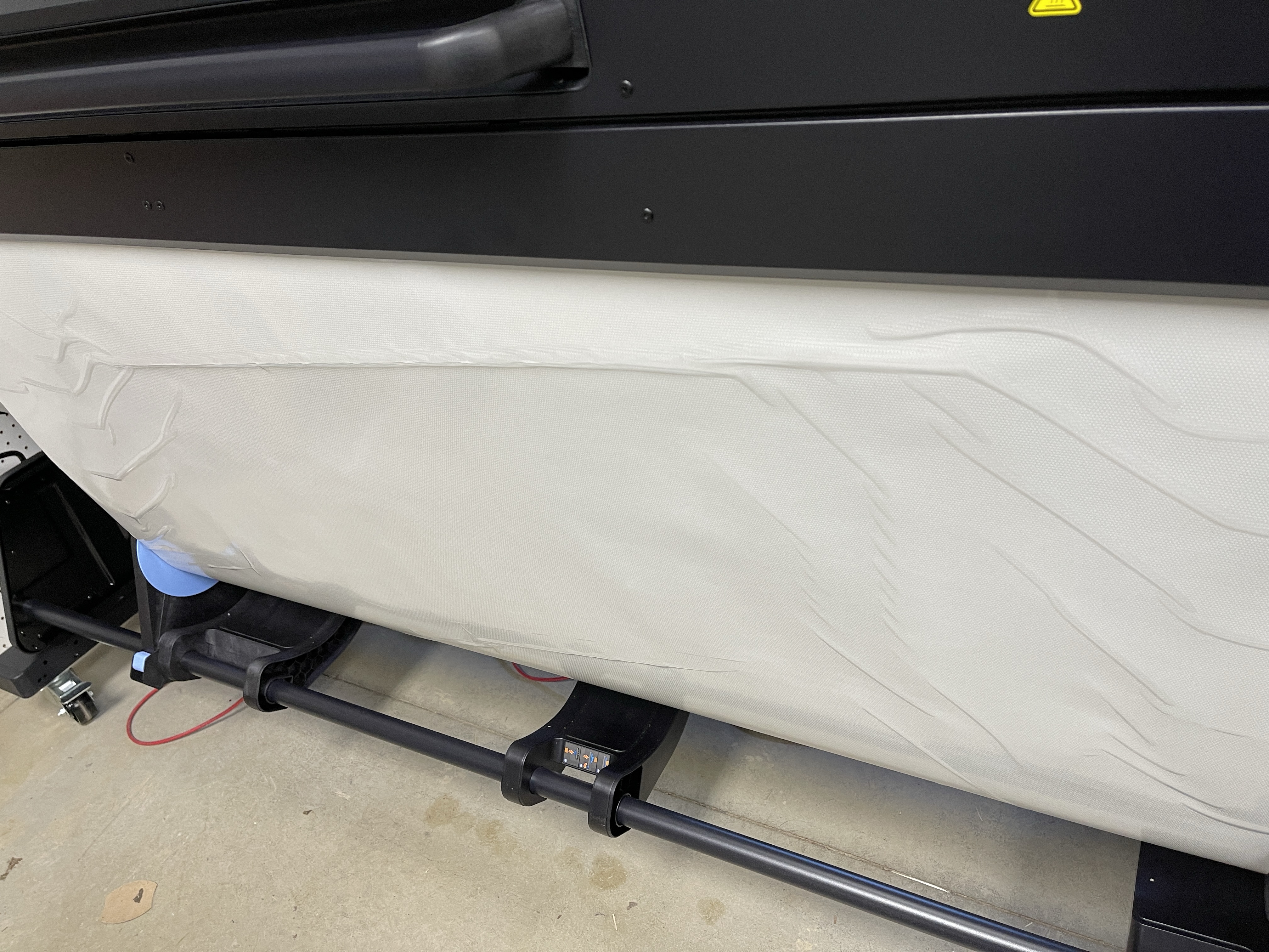

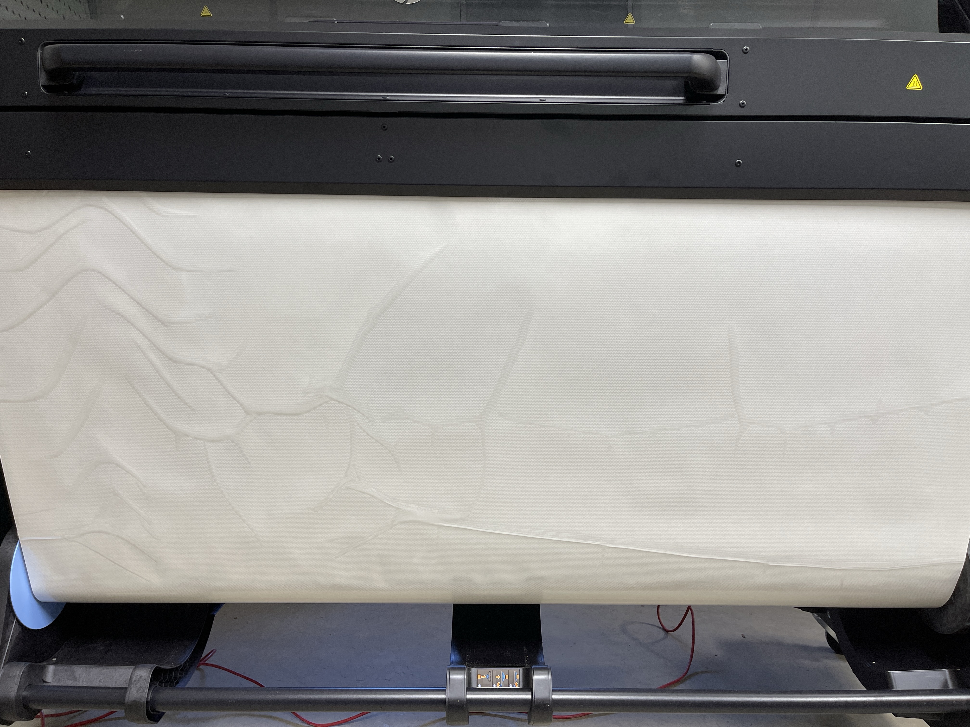

I using the preset that is available online for 5 layer. At time it is fine and then I will get a section that starts to tunnel. Anybody have any advise for this problem.

How much curing heat on that profile? With 5L it's absolutely cooking in the oven for a while so you may want to go down and make sure drying is as high as it goes.
On another note, maybe some alternative media is a better match for that application.

It appears the it was a defect in the roll as it only appeared in 2 places so far and it was before it got to the curing area.
