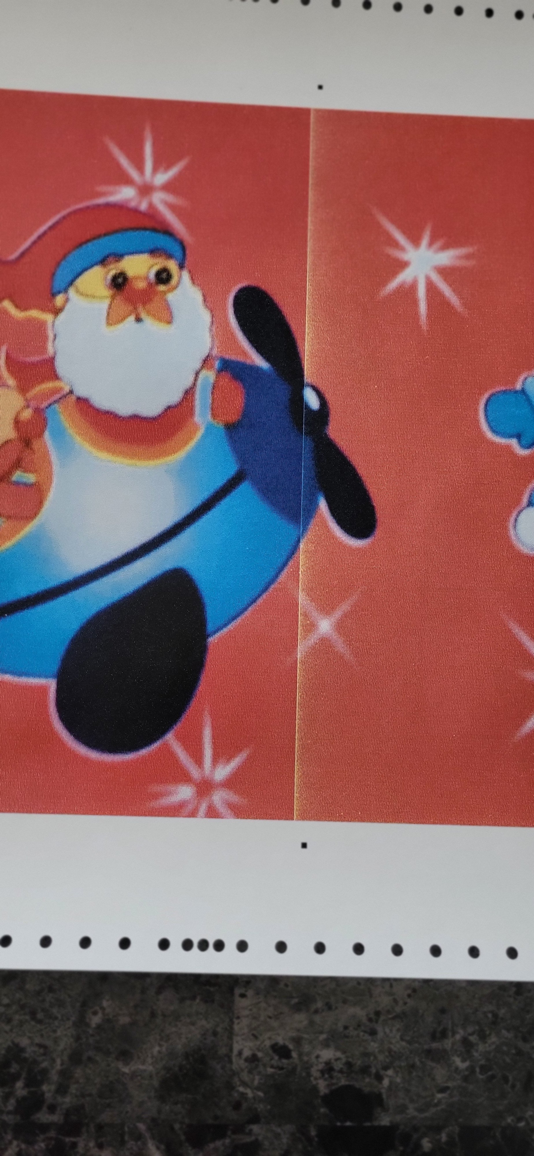

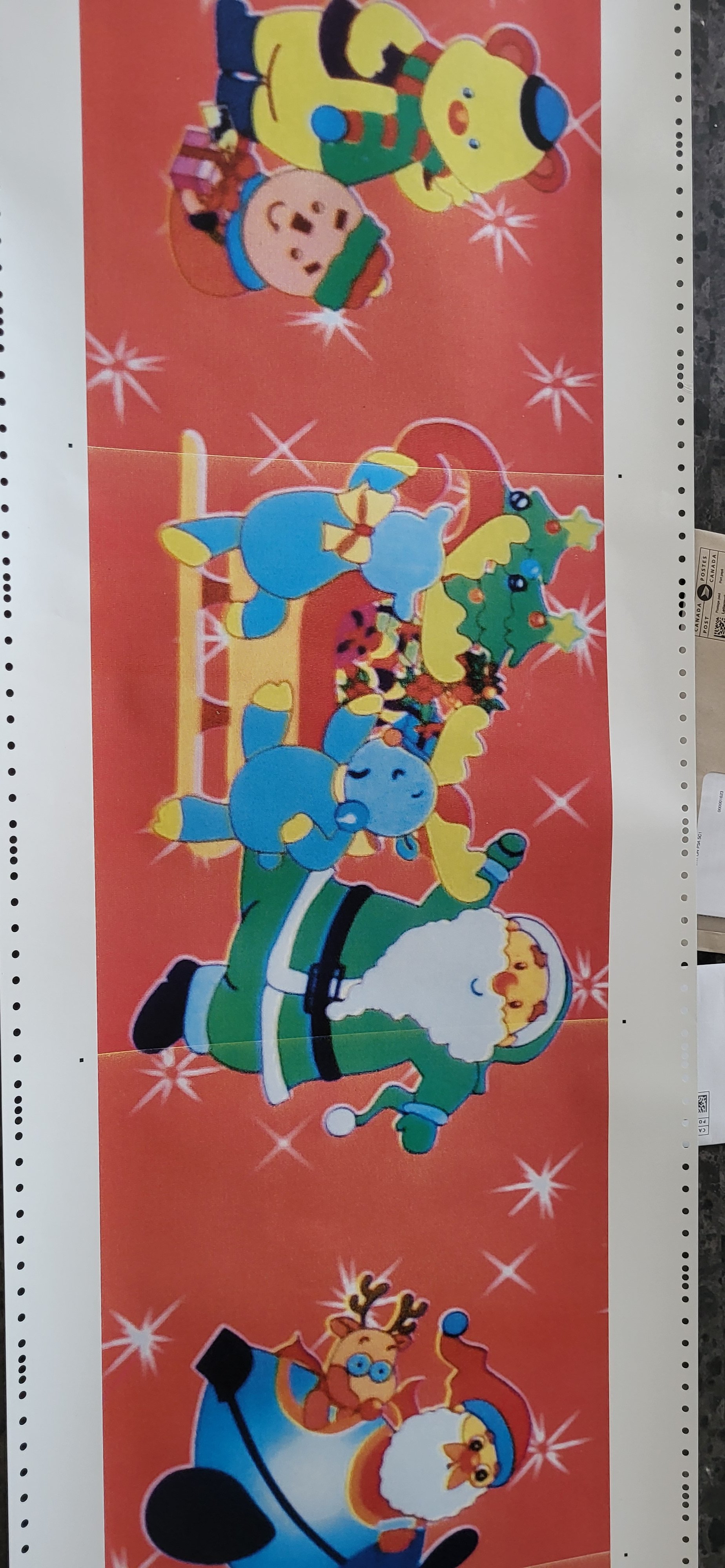

hello first post here and new to Gerber edge (hobbyist) i did read 20 page of forum and could not find a solution here is my problem ... edged fx omega 6.5 ...stand alone dell (no internet ) with window 10 been printing small stuff for few month and now i have a 4x4 ft project and the problem is every 1 ft or so the printer stop/pause but the foil tray keep moving-rolling ..sometime it stop for 1 or 2 second most time or so long that I Actually have to pause it ( or waste the hole foil running ) tray lift up ,,,then put it back online to continue printing but when it does it make a line like its missing print . i did try the 3 colour mix or the solid one and still does it i try to change the dpi to 600 and 1200 and its worse it does every 6 to 9 inch is there something in set up that i not doing ? i put some picture so easier to understand thank for your help

no internet here, direct connection to the laptop I thought about the cable too but replace it with a 4 ft one and still the same. It does sound like memory or data transfer as sometime it take a while to get it to print (it would said online on the edge but noting move sometime up to a minute before anything happen .. does it sound like the print head data cable ?? thank for your input
